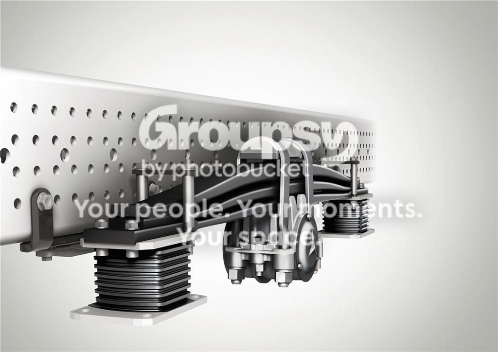

    yes they have but when terrain is so bad than only 25cm of axle walk is not enough , when truck sit on front driving axle and rear driving axle is maximum extended and as much you are going forward hole become deeper and deeper rear driving axle get lower and lower ....than too large extension and too large pressure take its....
    about that suspension on picture, scania use this on their air suspension , for single axle too uncomfortable , for 6x4 or 8x4 .... problem is what you describe , only 2bag per axle means lot more extension for same axle walk and axle is more rigid to frame so this is also not good for terrain if side angle is needed , of course there is less parts to replace and slightly better ground clearance but still i think it is pretty bad

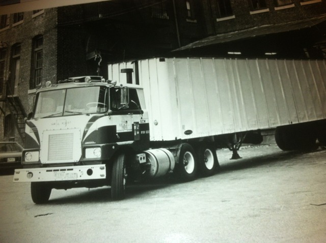

    does anybody have information about this truck ?as i understood it had mid engine configuration and flat floor in the driver area
