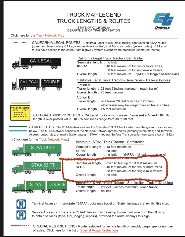

    Random questions that I think of while I'm driving lol....so anyways how does the 40 foot KPRA law in California work with spread axles? I'm genuinely curious because I never thought about that and then I thought about when I was hauling flatbed I realized that was something I never thought of until I came back to reefer and have well....the tandems. I don't know what trailers have spreads....I just know flatbed because I did flatbed and that was the first time I seen anything other than tandems.

    Simple really. Any trailer 48 foot or less was “grandfathered” into the STAA regulations. A 53 can have a spread set up, but must meet the KPRA. This is why you see 53’s with the rear axle forward and a lot of over hang of the trailer.
