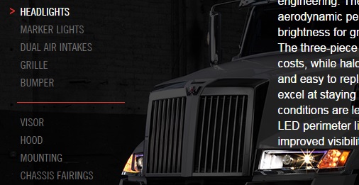

What bulb type do you put in the low beam spot?
  1. Halogen H7/H9
    75.0%
  2. LED (please specify kit and picture of beam on wall)
    25.0%
  3. HID (please specify kit and picture of beam on wall)
    0 vote(s)
    0.0%

    As far as plug and play led bulbs go, most are horrible...especially for high beams. The only one I've heard good things about is diode dynamics sl1 bulbs but they are pricey and may be geared more towards reflector housings.
    That headlight is a perfect candidate for a bixenon hid projector retrofit. I think you can find a direct bolt in option by the looks of those ones. www.theretrofitsource.com has everything you'd need to have the best lights you've ever seen...
