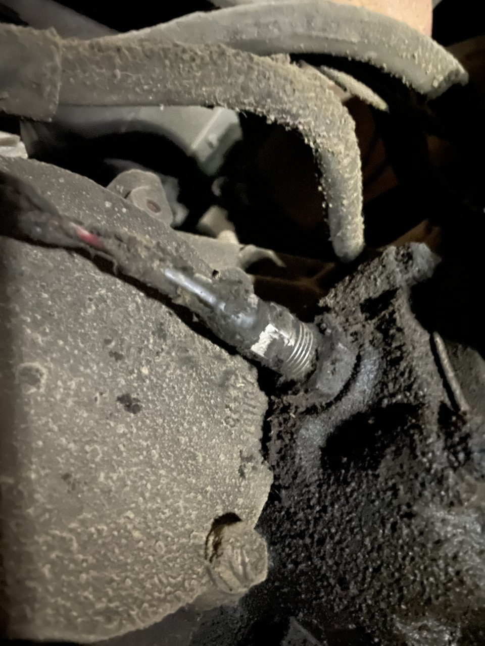

    We hooked it up to the computer and erased all “historic” codes. He eliminated the vehicle speed parameter(70mph) and we drove it. Started down the road, rpms were going higher than 1800rpm prior to each shift, just to show him, that it would probably drop back down in 9th or 10th. Got it up to 10th, truck was at 77mph and then rpms dropped to 1800. Went back, checked for codes and VSS, showed up. Codes 35 and 54, both related to vehicle speed sensor. So, I’m gonna go get a new one tomorrow and try it. IMG_4829.jpeg

    This plug has 2 wires per plug and 2 plugs. How far do I screw this sensor in and lock it down?

    I think those get twisted down by hand until they stop. Then, back it out about a quarter inch or so. Maybe a couple full turns then lock it down.
