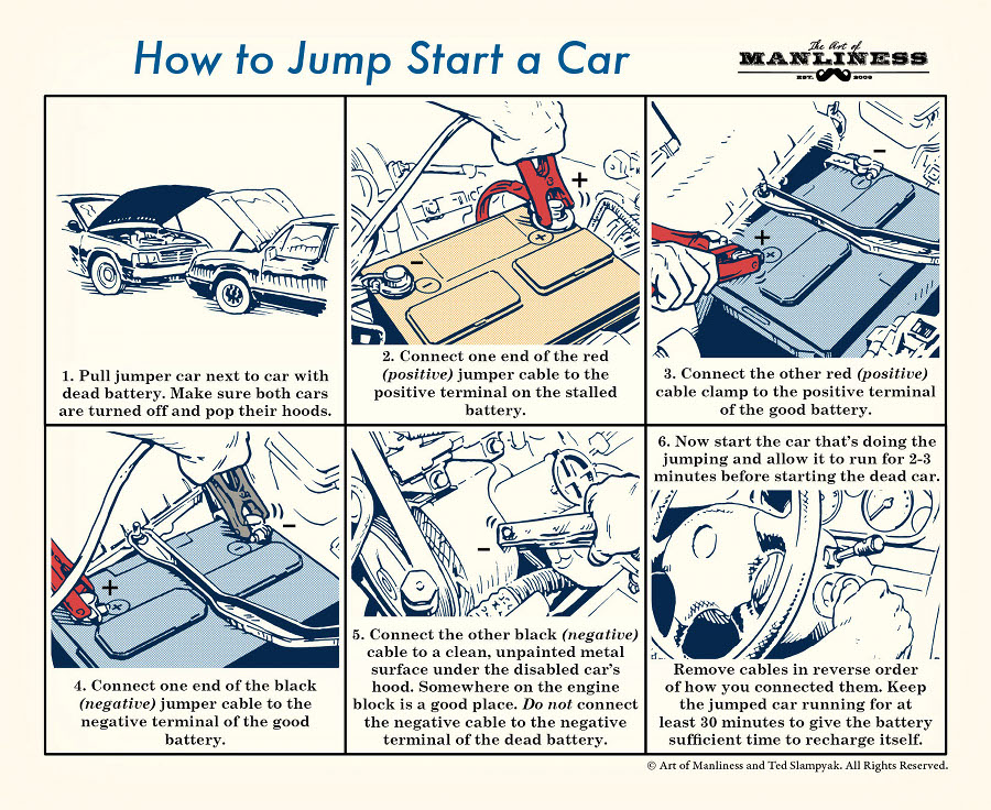

    I've always gone with this, never had an issue.

    Right.
    Positives first, then negative.
    The negative cable should be connected first to the good battery and then to a a solid ground of the disabled vehicle - such as the frame - so a stray spark won't cause an explosion from the battery.
    Connecting the positive leads after the negative will probably always cause a big spark right at the battery. Those fumes can be deadly if they ignite and explode.

    Repeating:
    What does your owners manual say about that?
