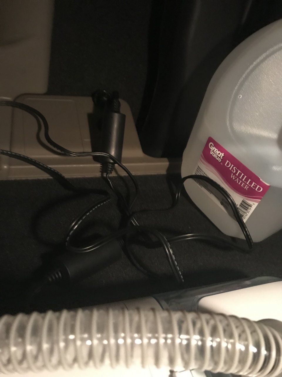

    Again, I’m an electrical dummy, but I think the inverter draws more than the item plugged into it.

    I get where you are coming from, but here is the thing, if your company requires you to use it (doesn't matter if you need to use it or not), then it is their problem to get you a jump or fix the batteries. Most battery sets can handle a cpap with humidifier load for 8 to 10 hours, have one bad battery and that time can go down to 4 hours. The load isn't much, I think it is 120 watts at the most but the batteries are a problem for most trucks.
    So here is what I wonder about, the make of the machine.
    Seeing that you can get 12 volt adapters for many of the machines (not cheap) to use while on the road, taking the inverter completely out of the scene, it would be a good idea to use one if your machine has one.
    the other thing and this is somewhat odd is to use a cpap backup supply in conjunction with the inverter. It is complicated to explain but I think they make a few where you can run the machine with the backup supply and the back up supply is charged with the inverter, not taking a lot of power from the batteries.
