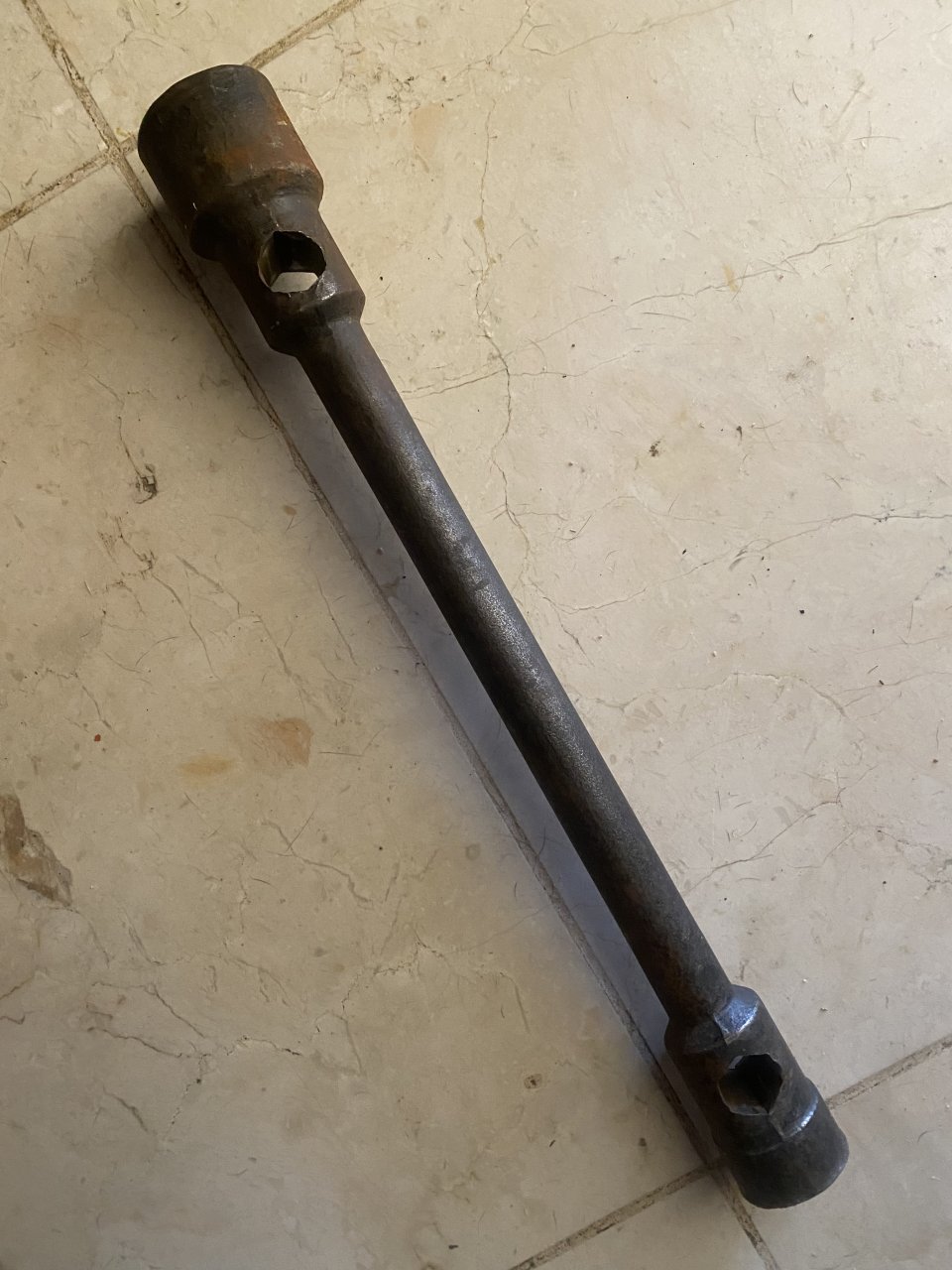

    Pop quiz; Do any of you younglins and/or newbies know what this tool is for ?

  6. Goodysnap
    Goodysnap Road Train Member
    Joined:
    Jul 12, 2017
    Messages:
    3,716
    Thanks Received:
    9,022
    That looks like a lot of work, is what it looks like.
    Got a flat on my pickup a few weeks ago. Sucker went down fast. I realized I’m outta shape and was kicking myself for not having my cordless impact with me. Sad it was……
  7. REO6205
    REO6205 Road Train Member
    Joined:
    Feb 15, 2014
    Messages:
    13,172
    Thanks Received:
    60,496
    Location:
    California.
    I'm a long way from being a newbie but I know exactly what that is. I wish I didn't. We have one, sometimes two, in every rig.

  8. Gilbyson
    Gilbyson Bobtail Member
    Joined:
    Apr 26, 2012
    Messages:
    36
    Thanks Received:
    57
    Location:
    Wyoming
    The picture needs to include a jack stand, a 5ft cheater pipe, a can of PB, a hammer, and a map gas torch.

  10. Diesel Dave
    Joined:
    Jan 20, 2010
    Messages:
    8,716
    Thanks Received:
    24,947
    Location:
    Hesperia, Ca.
    I used this same tool to bust the inner and outer studs/nuts on my own on 2 axles when I did my brakes back in the 80’s. No torch, just a rod and breaker bar. My point is, I had to tighten everything back up the same way and never had a lug nut get loose. I even remember one day I had to get a flat fixed and there 1” gun had a hard time trying to break the lug nuts off. So again, “Torquing” what ? Btw, a few years after that episode, I had enough money to go buy an air compressor and air tools.
