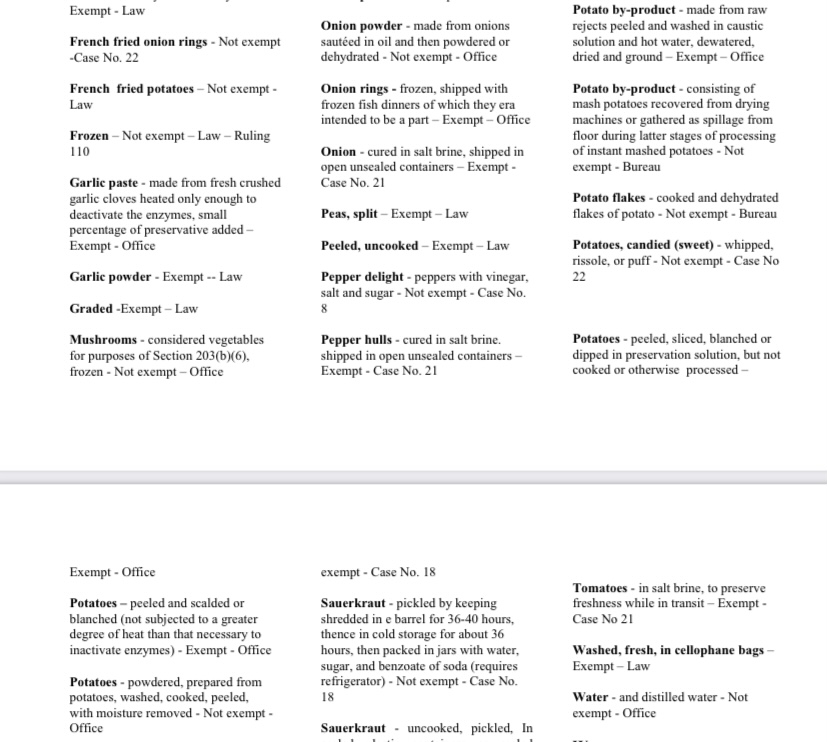

Can I use AG exempt

    Kind of hard to follow the FMCSA list, but you can see what is and isn’t exempt as far as potatoes are concerned. Bagged potatoes that haven’t been cooked appear to be exempt.
    Make sure you stop before you exit the other end of your exemption if you haven’t been off duty for 10 hours yet, that way you don’t end up starting your clock again and end up having to take a full 10 a few hours down the road. Stop early and leave with a fresh 11 sooner.

    This is going to be a state by state thing, also a lot of time it needs to be tagged as farm and “for the benifit of the farm” to qualify

    Actually you could look at the beginning of the veggie section is where bagged veggies are said to be exempt. Bagged and sacked I think means the same thing.
    You can see in the table this - Vegetables, Bagged >>> Exempt.
    I don't think the potatoes are dipped for preservation, one reason why I was asking where it was going.
