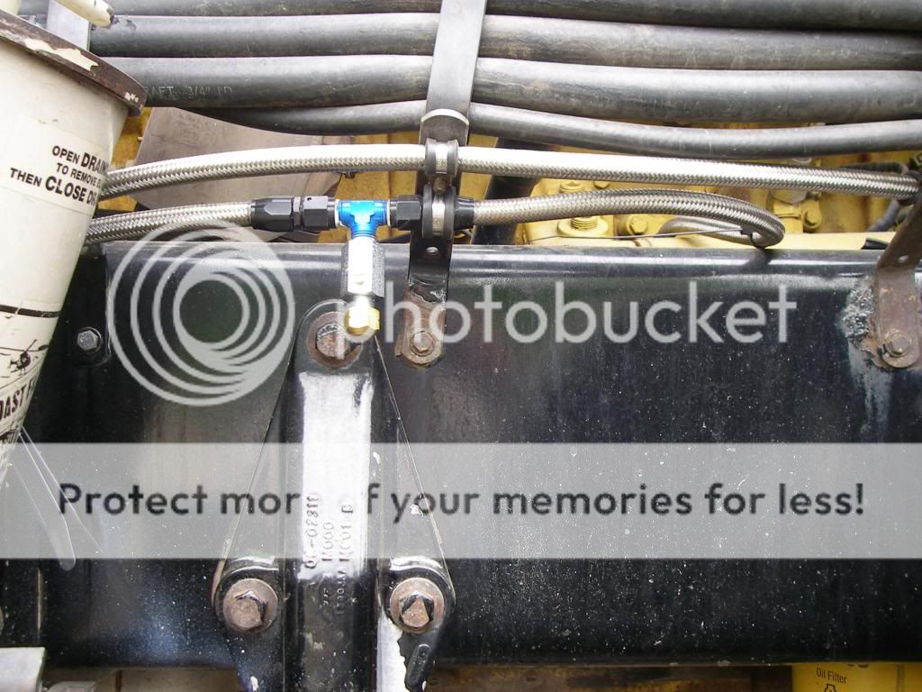

    80k on my oil with the Gulf Coast system, my samples come back great every time. I sample every 10k and change filters every 12k. The systems can be pricey as an initial investment but, if you are savvy and seek out the parts and install it yourself you can save a ton.
    For example I bought my GCF2 housing used as a military take off, got some braided stainless line and some AN fittings from Summit Racing, fabbed a mounting bracket and I was all in at approximately $300. Here are some pics of the install:
    It's a great system that gives me a lot of piece of mind by monitoring my wear metals, soot, additives etc.
    I use GCF filters and participate in their analysis program.
    At filter changes I add 3 gallons of make up oil, 1 that the truck is usually down between changes and 2 more to top off after draining the housing to get the filters out with no mess. Takes about 10 minutes to do that.
    You cannot go wrong with a set up like mine.
