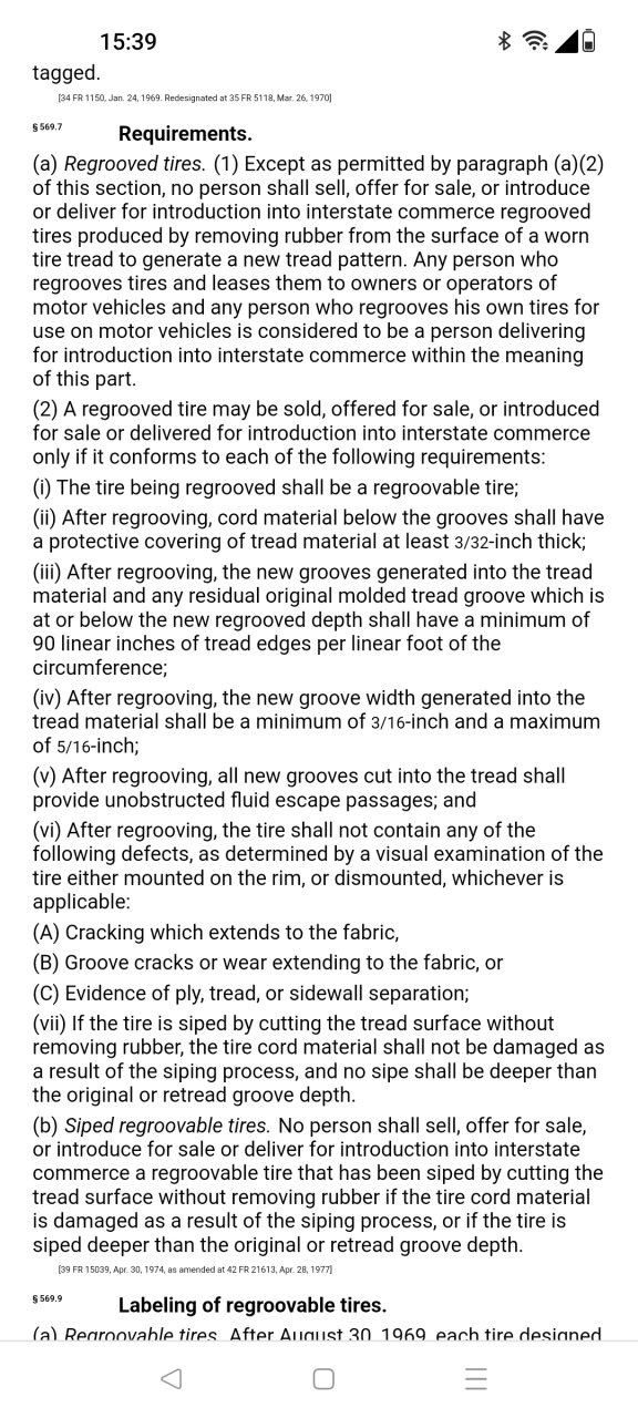

    I found na explanation in the fmcsa finally. So regroving is legal like you all said but there are standards. New grove depths, minimum and maximum grove widths. Among other things. Another site stressed the importance of doing it at a shop by a tire mechanic on their machine. Judging by the 25 year old new mechanic out there with a harbor freight grinder I'm assuming I'm right that the new groves aren't with in the standard lol
