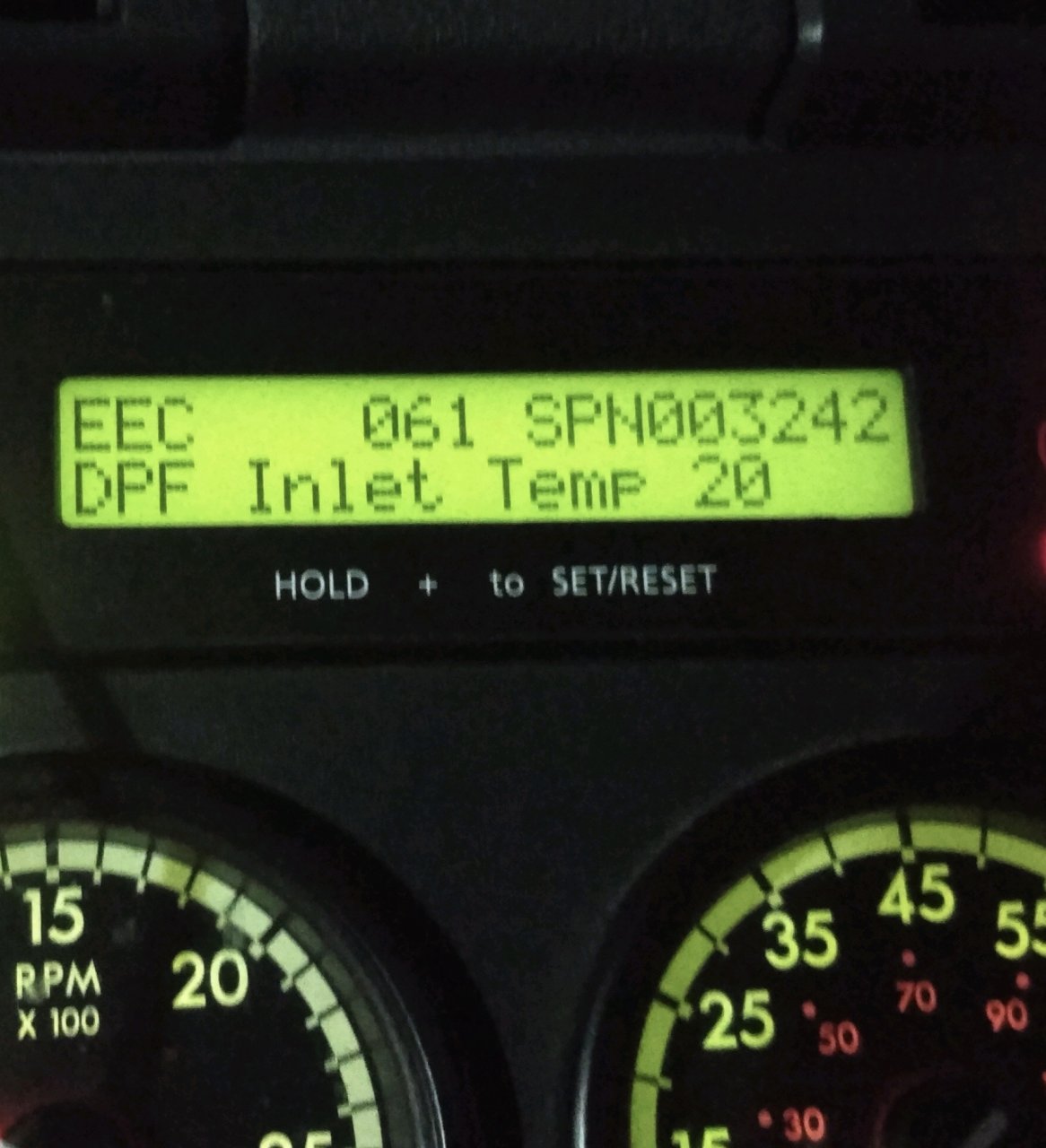

    I am getting EEC 061 SPN 3242 Code with DPF Inlet Temp 20. Does this mean the inlet temp sensor is bad and will replacing the sensor clear the code or does it need to be hooked up to the computer?? Also If I just ignore this code, will it still regen?

    You also need the failure mode. It will look like SPN 3242 FMI #.
    SPN 3242:
    FMI 2 DOC Inlet Temperature Sensor Plausibility Error
    FMI 3 DOC Inlet Temperature Circuit Failed High
    FMI 4 DOC Inlet Temperature Circuit Failed Low
    FMI 8 DOC Inlet Temperature Signal Spike
    FMI 10 DOC Inlet Temperature Sensor Stuck
    My first suspicion would be a bad harness, but it could be a bad sensor.

    It doesn't give any FMI# I have attached a photo of the code. The MIL and CEL lights came on but after driving it a little the CEL light went out and but the MIL light is still on

    Get a ScanGuage if you don't want to buy the DDDL software or go to a shop. The MIL will go out after a while - usually four or five start/drive cycles. Regens should work as long as the CEL stays out out. If this happened once it'll happen again.
