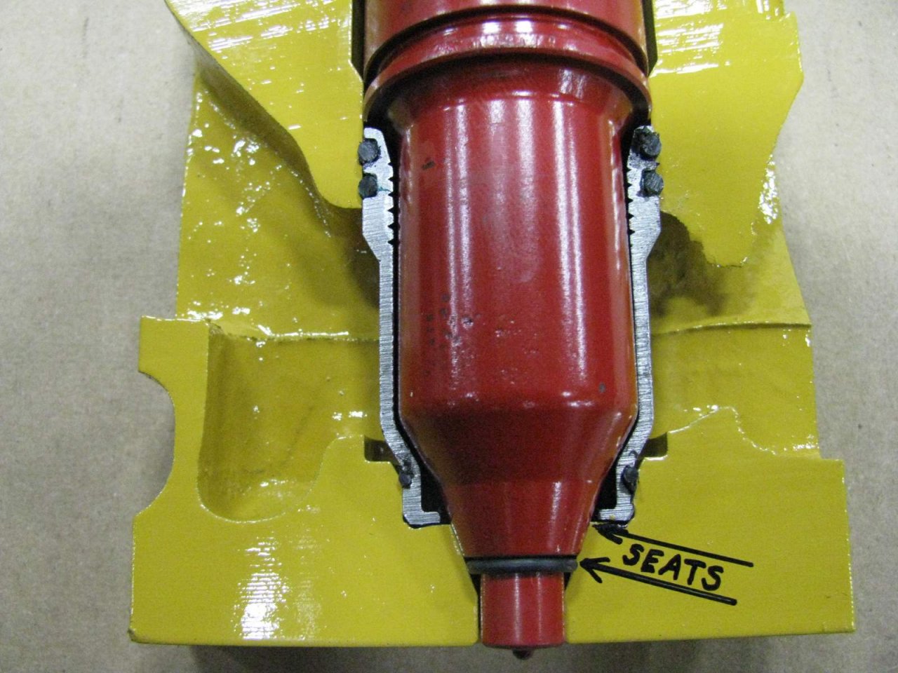

    Swaan, i have a question. How do you know if injector seat no longer trued up ?
    CAT ran sight glasses , one pre, one post head, sight glasses mounted on pass side mirror, nothing showed, zero air whatsoever.
    What im thinking is , if a injector seat is failing, somewhat of a burn mark or whatever, will be on the seat of that injector itself.???
    First o-ring just helps to form carbon dam and is sacrifical. If gas travels past seat, it moves up and eventually passes past middle o-ring getting combustion gas in fuel. One I seen with bad seat had soot on lower part of injector above seat and blueing from heat. Middle o-ring was not gone, but looked slightly charred. This problem is why Cat wants you to replace injector hold down bolt Everytime it's removed.
