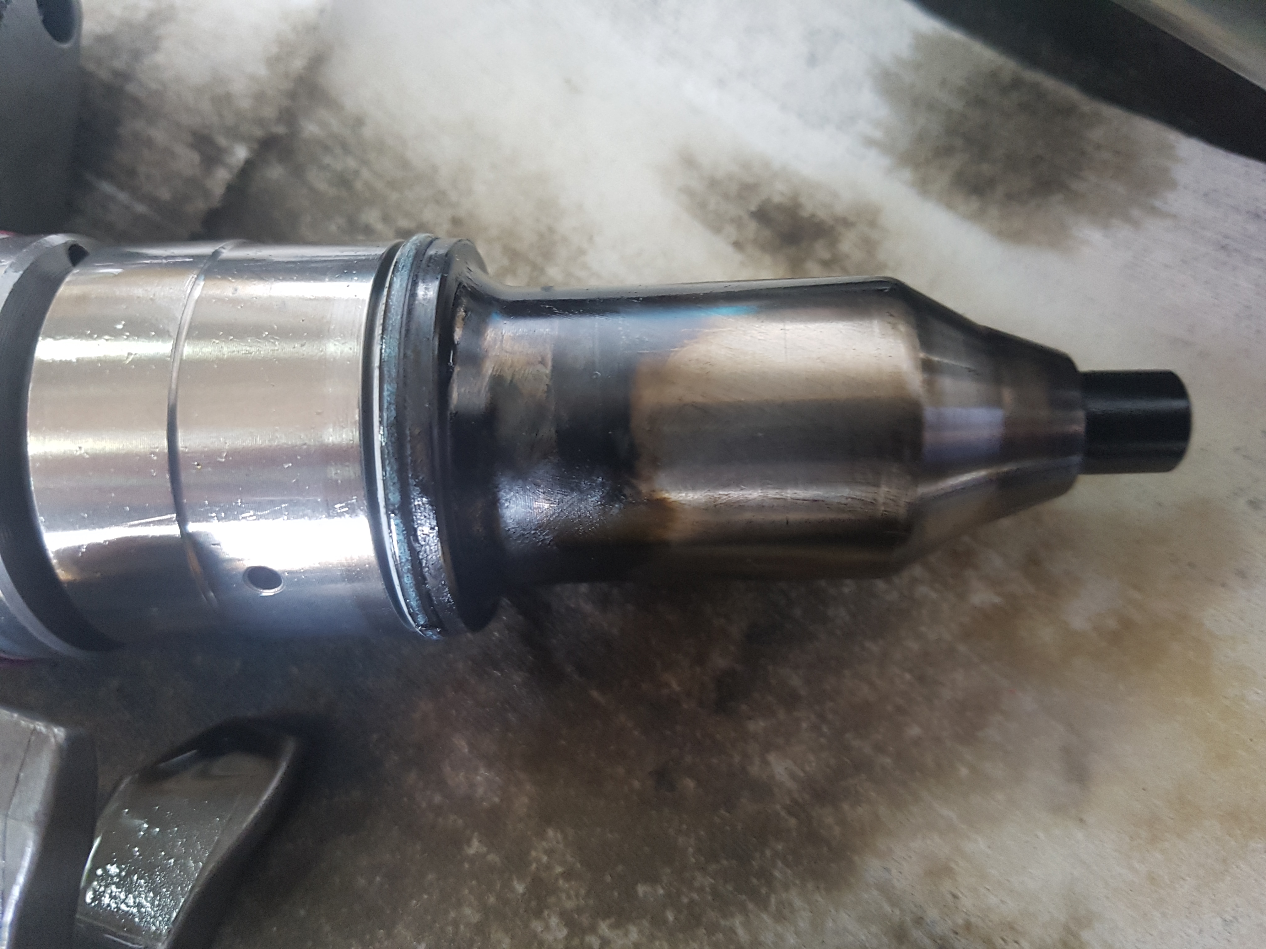

    this is what 5 of the six injectors look like

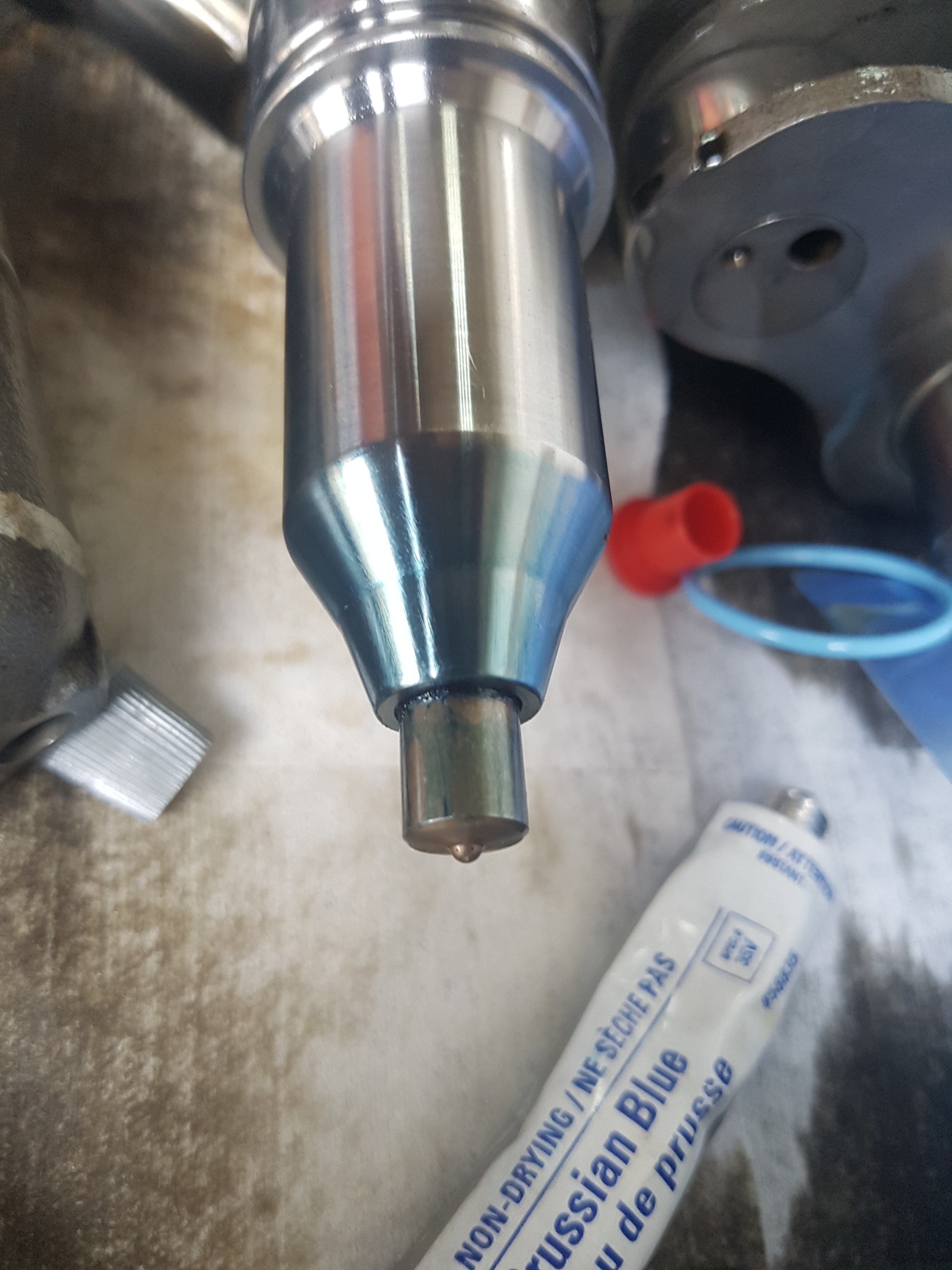

    this is the sixth, slightly better but still bad
    wore out, Oxbow and SAR Thank this.

    Wow Troy.
    Wow Troy. Carbon burned from combustion bypassing seats.
    But I bet you let go of a big deep breath when "finally" you found the end of a long dilemma.
    Staring out the glass wondering, thinking, and guessing all day. Going to bed / waking up / eating etc constantly thinking , picturing every function of the engine and beyond, trying to come to a conclusion to get it over with.
    I hear ya.
    Glad it's over for ya and you can get back to thinking about other stuff
    ( if you remember what you use to think of before being married to solving the problem!!)
    Great to hear Troy.

    this has been an issue for me since 2014, 2 years after the platinum rebuild. tech says those injectors have never been properly seated from the start. there should be a carbon buildup where the lower o-ring sits that helps to seal the injectors in the seats, the o-ring burns up and carbon replaces it...not one of the injectors had any carbon on the tips.
    I'll see if he'll send me the borescope photos tomorrow. all the seats are warped or uneven, one even has severe pitting. tech said he has never seen anything like it.
    and yes, I am beside myself with joy...this has to be it!!
    peterbilt_2005 and Oxbow Thank this.

    they are going to use prussian blue dye to check the injector to seat surfaces on the new head before installing it on my engine. we did it with the new injectors on my old head and every seat had abnormal contact with the injector. the seats in the reman head installed during the platinum rebuild was never machined properly from the start according to the tech and the service manager. the engine is 2 years out of warranty, but we have paperwork showing this was an issue that wasn't resolved before the warranty expired. all parts on warranty, new injectors and head, but we have to eat the labour. will be around $4K Canadian when it's done, but if it stops running like a bag of #### under load it will be worth it.
