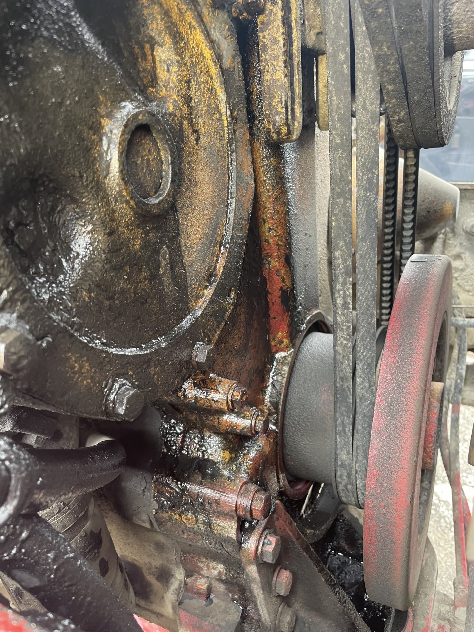

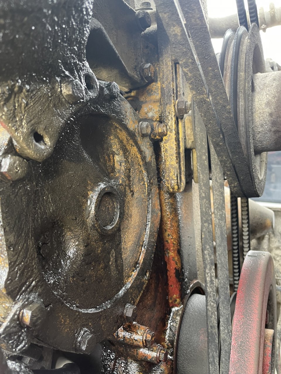

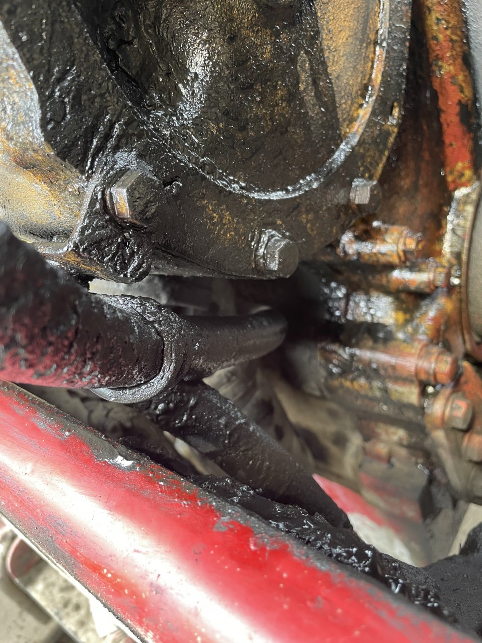

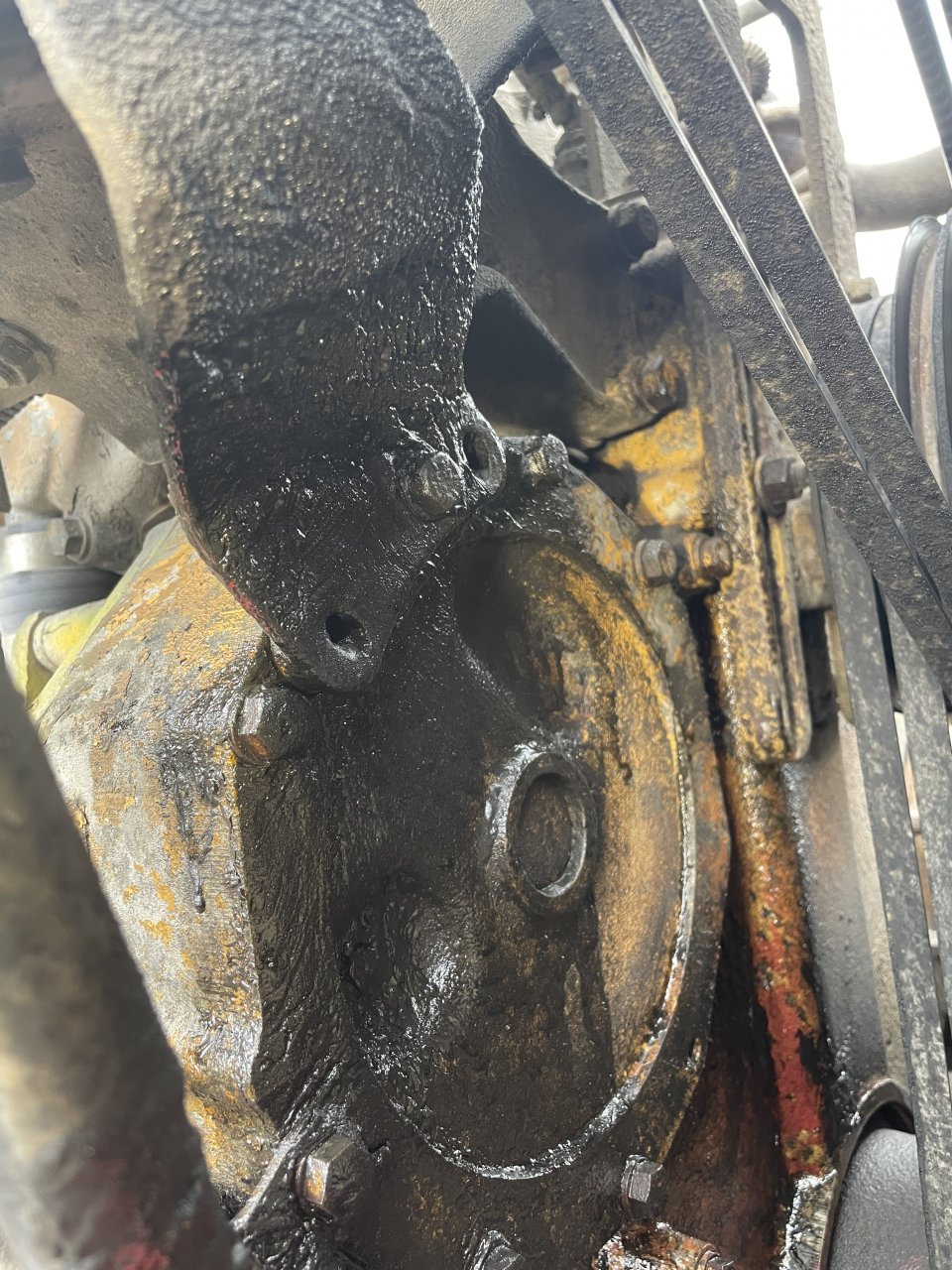

    Hi guys
    I have an oil leak and I was thinking it was the front crank seal, maybe this is my issue too, can anyone send a pic of the studs that you guys talk about?
    I took these pics a couple of days ago how bad mine looks like but when I check my oil level still on the max, I just changed it last weekend.
    Thank you for the help guys and sorry to high jack this thread.
