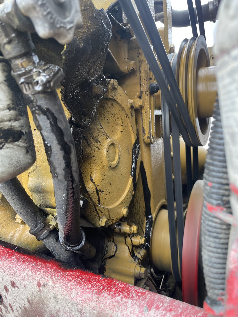

    Guys I finished everything yesterday left the truck idle for 1 hour and no leaks and today went to work and I found an oil leak but now is not from stud as far I can see. IMG_1365.jpeg
    Any ideas ? Maybe is the front structure seal that I need to tackle
  10. 1990pete379_3406B
    1990pete379_3406B Bobtail Member
    34
    25
    Feb 3, 2022
    Does anybody knows what is that round cover where the bracket is missing a couple of bolts? Can I remove that round cover to check if that’s my culprit? Is that round cover the water pump?
  11. 1990pete379_3406B
    34
    25
    Feb 3, 2022
    Hey Guys, does anybody has the steps on how to remove the front cover and parts number for a gasket kit? I am planning to get it done to get that oil leak out of my engine once for all! I really appreciated it, my new belts are ruined already
