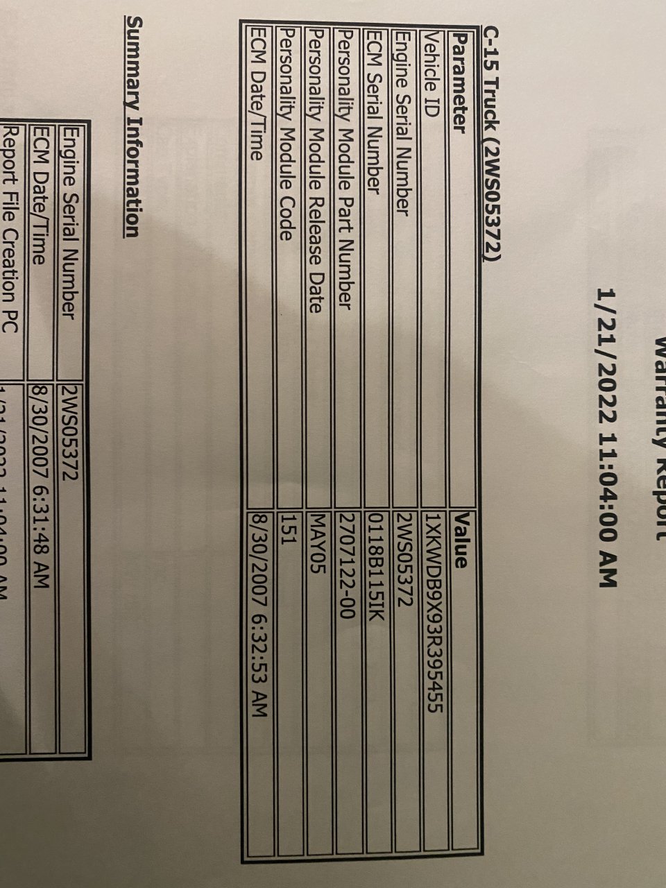

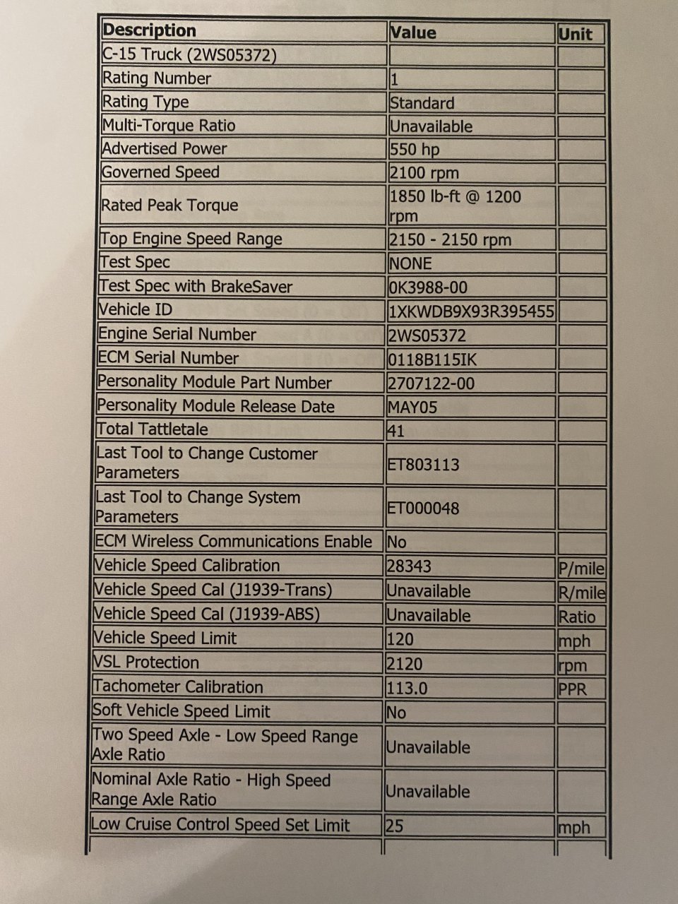

    So today I found out that my engine is a MBN, but the ecm serial number is a 2WS. It was rebuilt by kenworth in 2018 platinum rebuilt
    with new ecm. Because I have original overhaul paperwork so I called to get previous details. Ain’t it weird that maybe the previous owner flashed the ecm without changing any components. I ordered the overhaul kit. But confused if I should change the ecm to original or should I just keep the ecm the way it is

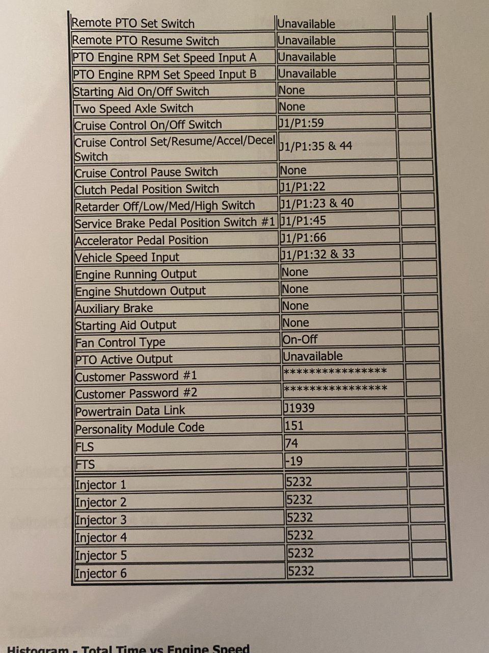

    These are the overhauled paperwork
    And the ecm information from cat

    I won't go to deep on this topic but If the ECM is reading a 2WS serial (possibly someone attempting to skirt e-log rules, though in vain.) it is hard to say exactly what motor configuration is in your truck without looking at it, but most likely being a MBN originally it is running a tune for a 6NZ which will run way better and get better fuel mileage than any of the actual MBN tunes will do.
    I see it shows to have flash file 2707122 in it which would be a 6NZ file as I suspected, I would keep what you have for the ECM.
