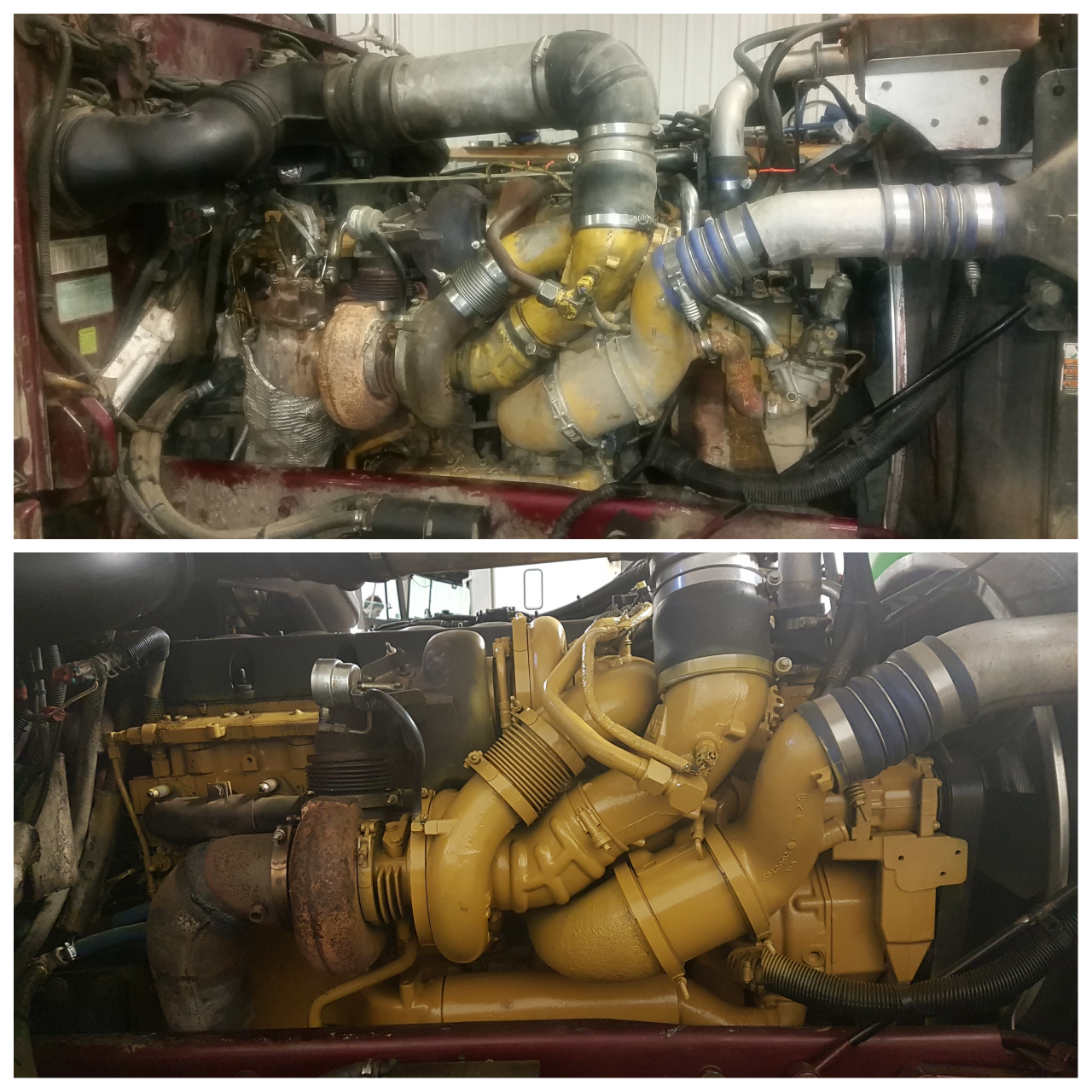

    I wouldn't ever waste my time doing anything but all holes, just seems like you'd be asking for trouble.
    Sending the head out Monday, counter bores all getting cut Tuesday, new spacer plate being picked up (will mic) , epoxy for my water jackets at that time. New liners are being ordered in and I'm sending my new head bolts, turbo and exhaust studs in for a cryogenic freezing treatment.

    I'm running Mahle pistons. Im reusing the pistons, rods and wrist pins as they've only got 4 months use on them.... new rings.
    The liners all measure decent but I'm replacing them with FP Diesel (Federal Mogul) ones for good measure.
    I am not a fan of Cat reman at all when it comes to liners and pistons.

    As you can see, the emission side is not my issue as to why I've kept them active....
    I work in the Alberta oilfield where modified cats are very common and guys have the money to build how they want. I have never met a guy with a cat who has not been surprised how much better on fuel mine was. I've got friends with sdp converted 6nz, MXS and nxs, original 6nz and even bridges..... I just assumed my 18:1 was the reason why my fuel mileage has been better so I never even considered changing it.
    I wouldn't be overly concerned about price to do it as I was planning on replacing both turbos and the brackets and manifold right now anyways.... a single swap would be dirt cheap compared to.... I don't see any reason to swap the ecm though? Anything that a 70 pin needs can be programmed into my current ecm.
    Great info and I seriously appreciate it! Durability is something I really am thinking about right now as I'm sick of opening this engine up!
