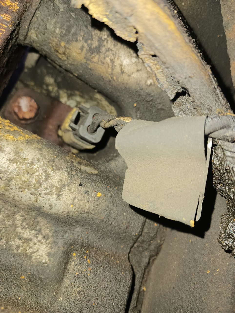

    Hi everyone,
    New member here. Excited to be a part of this forum. I'm a driver for a small start-up in Upstate NY. They purchased a 2005 Kenworth T800 on auction. It has a C15 Cat and a 10 speed Eaton Fuller. Not much is known on the history of the truck.
    I'm still learning the different parts of the motor. I've never driven anything with a CAT motor. I have a engine code for SPN0190-8. From what I have found, it relates to the Crankshaft timing sensor and either I have a bad sensor or a wiring issue. I think I found the sensor but would appreciate it if somebody could confirm. I found it below the power steering pump tucked into the lower part of the motor.
    If that is the right sensor, what is the best approach for diagnosing it? I think it's worth noting the truck runs very well even with the code in the system. Thanks everyone for your time!

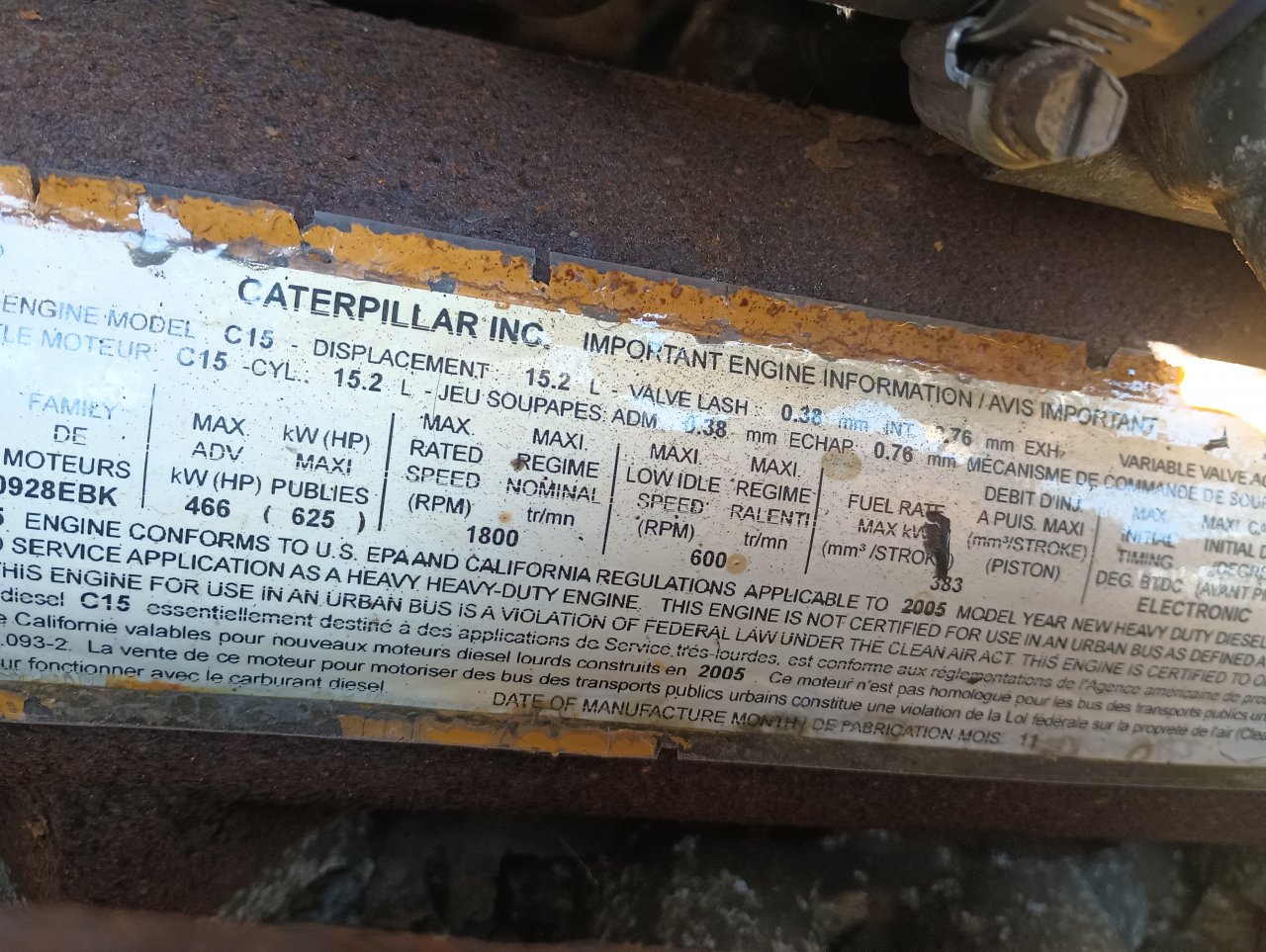

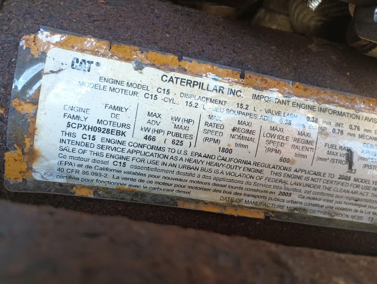

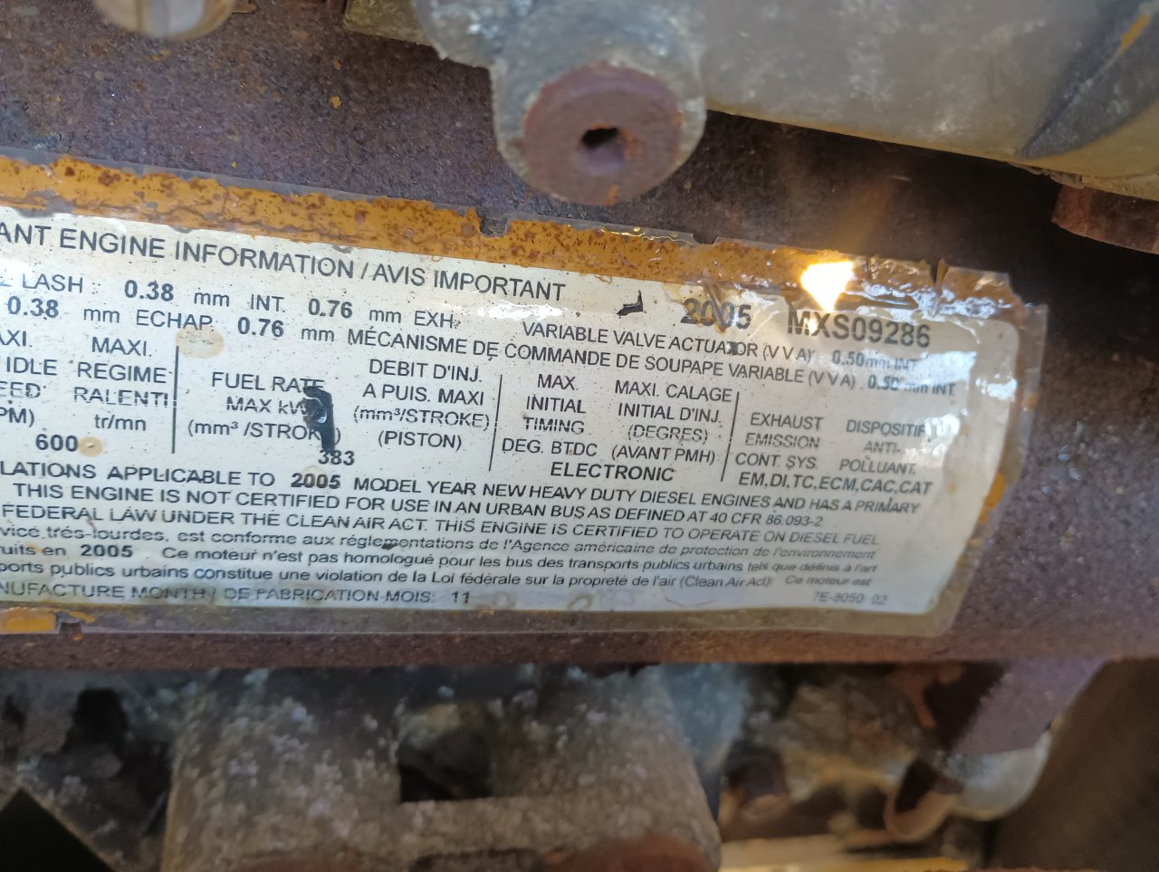

    Thanks for the reply Nightwind! Does anything on this tag show the motor VIN? Motor Info 1.jpg Motor Info 2.jpg Motor Info 3.jpg
    NightWind Thanks this.

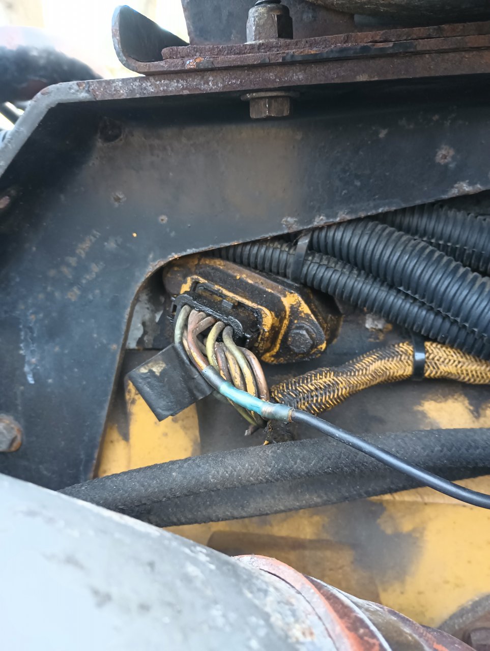

    Will do! Somebody has clearly been messing with the wiring on this truck, but the wires leading to this sensor (Crank sensor or not) don't appear to be touched. Are you familiar with the C15? There is a wire repair job from the ECU to a connector near the top of the valve cover and I'd like to know what that connector is for. There are two of the connectors. ECU(1).jpg Unknown plug (1).jpg Unknown Plug 2.jpg
    Oxbow Thanks this.
  9. AModelCat
    29,781
    165,623
    S/N is on the tag in the pic. MXS09286 it looks like.
  10. bjytech
    bjytech Light Load Member
    247
    223
    Nov 9, 2013
    The plugs up by the valve covers run your injectors, jakes, and intake valve actuation systems.
    As for your crank sensor code, that specific one typically indicates a wiring issue, it could be the sensor too but I've seen many times where the wires going down to the sensor get rubbed behind and just below the air compressor.
    By the looks of the engine sensor harness it wouldn't be a bad idea to consider replacing it.
