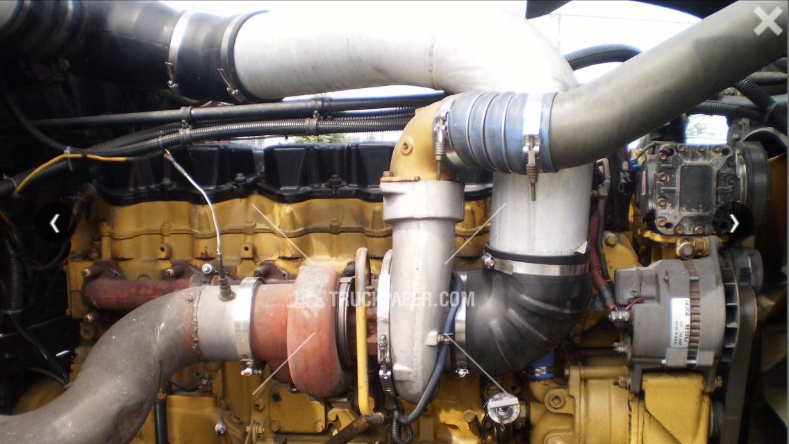

    so I got parts together to convert to single turbo,,,I have acert in a 05 classic, does anyone have a single turbo in a classic? I'm trying to figure out inlet piping from air to front of turbo. maybe like a e model.

    image.png Like this? Search truckpaper

    that's close but my air to air is more centered on the side,,
