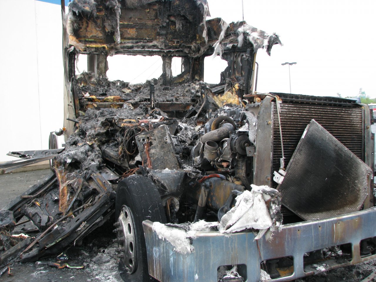

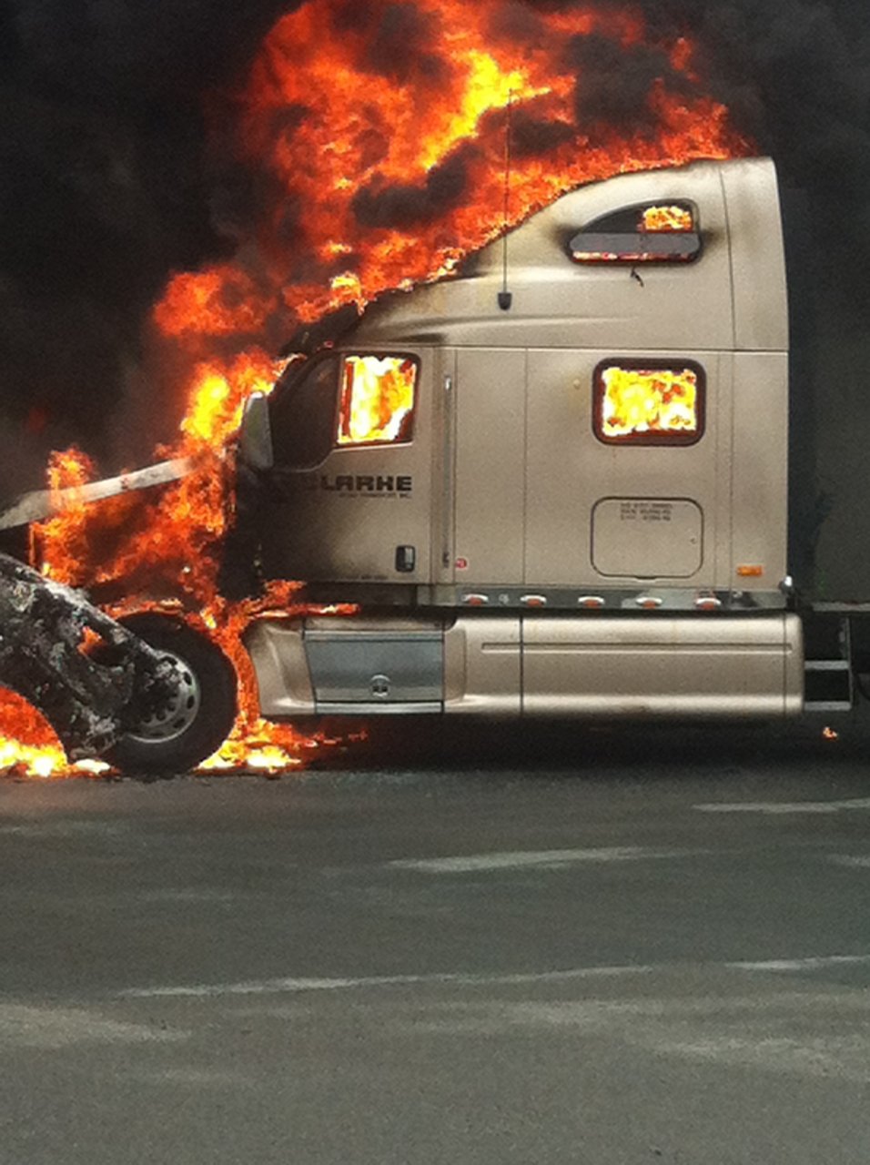

    The night before I was. Every truck since has 2 smoke/c02 alarms. Too close a call for me.
    I've posted these pics on here various times with the Hope's EVERYBODY invests in smoke detectors. I wasnt there, I had dropped it at the dealer for grease and a clutch adjustment on the new clutch after it seated. A tech was out side and smelled the wire burning, saw small flames and melting plastic from the cables dripping down, went inside to get keys to open the hood, (inside release) and a minute later when he got back with keys and extinguisher, this is what he found. It went up quick. Very quick.
    Once again.
    EVERYBODY GET YOURSELVES A SMOKE DETECTOR.
