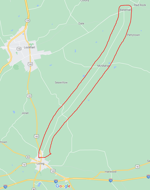

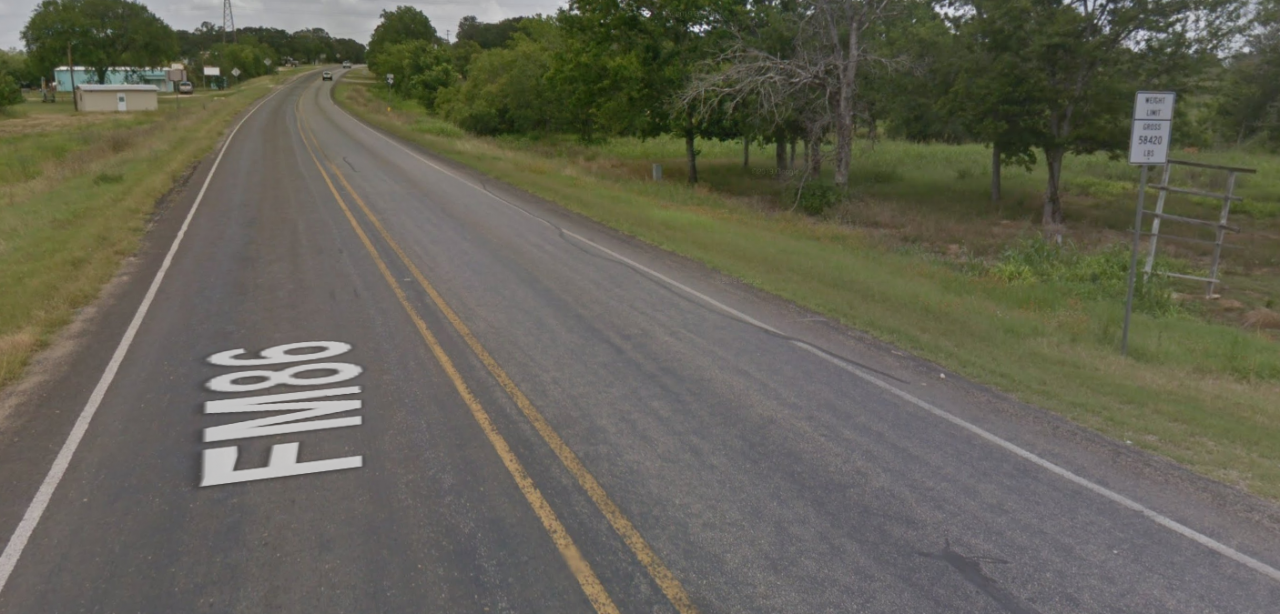

    Yeah, that's the ones I'm talking about. Where the sign is a hundred feet or so after you already turned onto the road. I make my route in Google Maps, and then I trace the route against my atlas looking for restricted roads. Once I customize the route to my liking, I'm on my way. But I've still ended up on some of them. Here's an example. We traveled FM86 all the time when I was in the oilfield. Wireline trucks, cranes, frac pumps, water haulers, you name it. It's not in the atlas, but it is on the website the atlas tells you to go to for "other truck restrictions in Texas". So if you get busted on this road you get a ticket, right? Or no?
    Edit: Here's the load zone website: Texas Load Zone

    So if I'm understanding you correctly, I wouldn't be at fault for traveling along FM86 from my above post, correct? It bothers the hell out of me knowing I might end up on one of these roads, even after I put in the time to route plan. It's happened twice so far.
