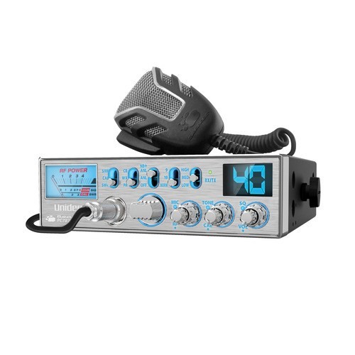

    I use a Uniden Bearcat PC787. Bought it when I was OTR..... only Werner driver that heard every complaint you made!... That was almost 7 years ago.
    Running it in my current rig with stock antenna I can hear for over 4 miles (randomly get base station feeds from the deep south - I'm in Maine) and transmit for almost 3 with a relatively clear sight-line.
    It's got a built in SWR / CAL adjuster. Only CB I've ever owned.
    Uniden Bearcat PC787 CB Radio
    Dexterr, Night Stalker10 and Timin770 Thank this.

    That's another good looking radio from uniden. I love the big s/rf meter it has. It reminds me of the Hy-gain V SSB mobile radio back in the 70's, it was an awesome radio too. I mainly recommend the uniden PC78LTX to new users, because it's has the same features and layout of the cobra 29 that most people love.
    The Green Mountain Thanks this.

    Thank God the thing has a dimmer. That blue can be real obnoxious when you're leaving out at 0200. Truly a great unit tho - functionally & aesthetically.

    Yes a dimmer is a must with blue lights. I personally liked the uniden pc687 myself. It still has the big meter, but the lights were yellow. Both radios have the weather feature. I believe the pc687 is around $50 cheaper than the pc787. I see CB world still sells these radios.
