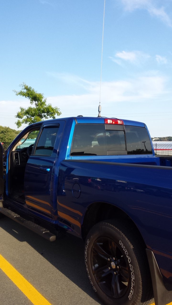

    Bought a new pick up in jan of 16..It was suggesyed to drill my roof to but eff dat..My sirio mag works just fine.. 20170811_183909.jpg
    rabbiporkchop and Meteorgray Thank this.

    That Sirio is a mechanical work of art. I would have bought one, but at 6.6 feet, it was a little too tall to get into my neighborhood with all the overhanging trees. I got a shorter Wilson instead.
    That Sirio big boy will challenge the 9-foot straight quarter-wave whips unless the 9-footers are also on the roof. There's no better placement on a vehicle than on the roof, proudly looking in all directions without obstructions.
