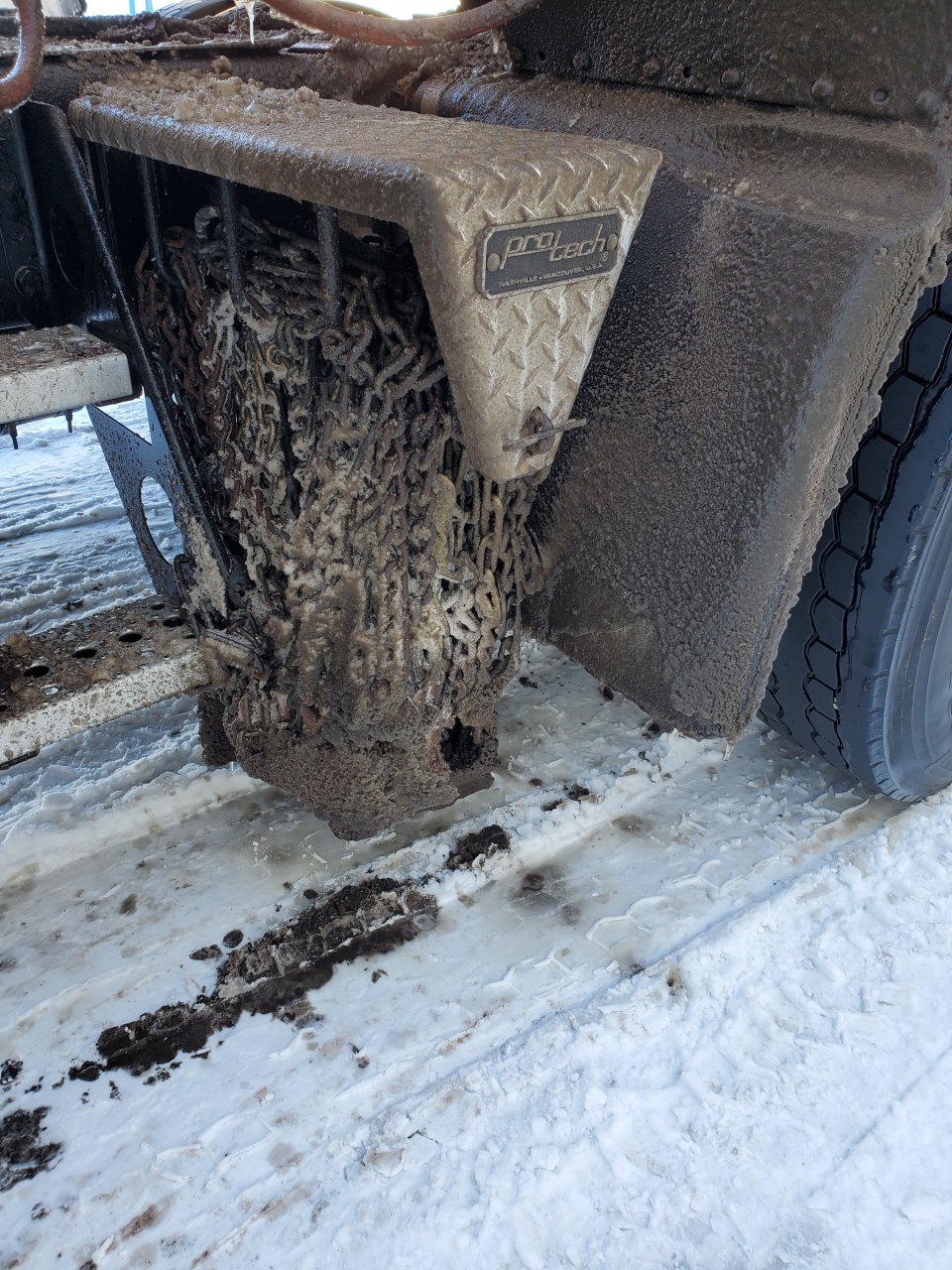

    Bring it home every day. Come along for the nonsense I deal with just to get to the beer... 20210215_172853.jpg
    No cables for this ol' girl then. This one's for you, Dave 20210215_172402.jpg
