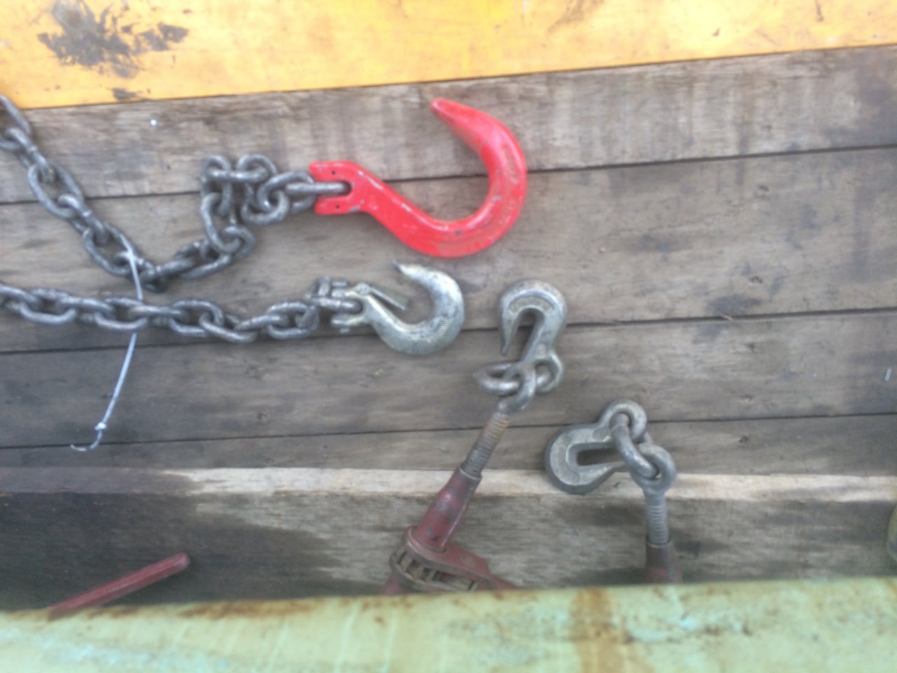

    Cause some times size matters ....

    Looks like the tools of a serial killer.

    The right tool for the right job ....,
