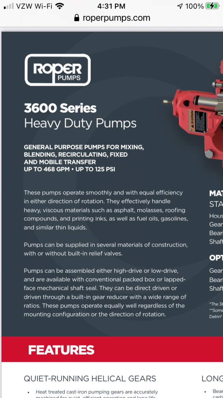

    Have a bulk lube truck, currently has a Blackmer pump. Want to swap out with a Roper, but this truck the pto runs counter clockwise(ccw), have a Roper that runs clockwise(cw), are Ropers direction ‘changeable’? TIA

    What model do you have? I believe they all can run either direction
    near the bottom it says either direction

    Sounds like it’s run with a shaft
  6. Lazer
    Lazer Road Train Member
    1,399
    2,181
    Jan 22, 2017
    3617 is the model pump. Yes pto shaft from an Eaton Super 10.

    The 36 series can run both ways…….

    Got it figured out, unbolt the front drive housing, turn it 90 deg. Re-bolt on, do the same with the rear housing. Thanks for everybody’s help.
