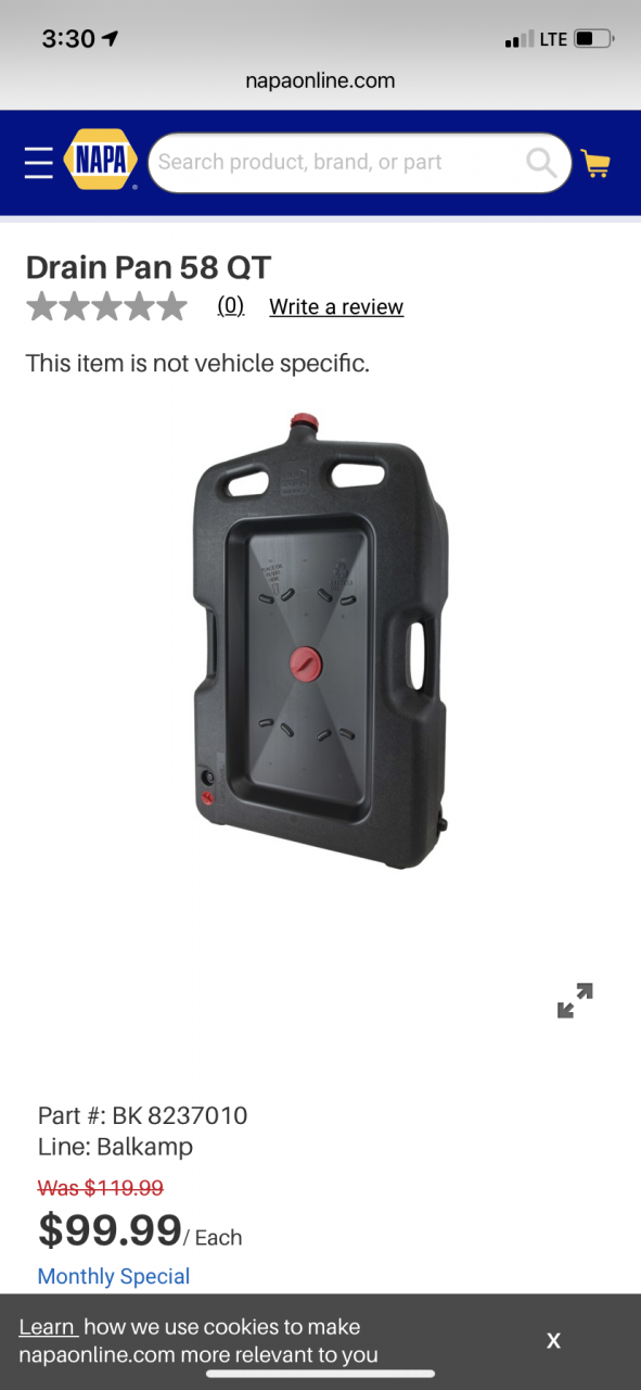

    That’s a flat out waste of money.

    I find it easier to just drain into a 5gal bucket. Having done a few oil changes at loves, it's also easier and quicker to dump the buckets.

    Use that for oil filters because they get messy.
