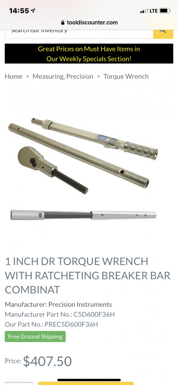

    Buy a 1” drive torque wrench. been using this style for over 25 years works great. Send in 1 time a year for calibration unless you drop it a lot.
    PermanentTourist Thanks this.

    Buying a $500 tool that I have to calibrate every year, for a job that I need to do maybe once every three years? Doesn't seem ideal. I think I'll just drive to TA and make then torque the bolts...
    Rideandrepair Thanks this.

    Already bought one on Amazon, thanks tho
