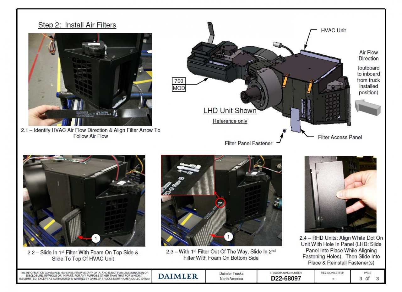

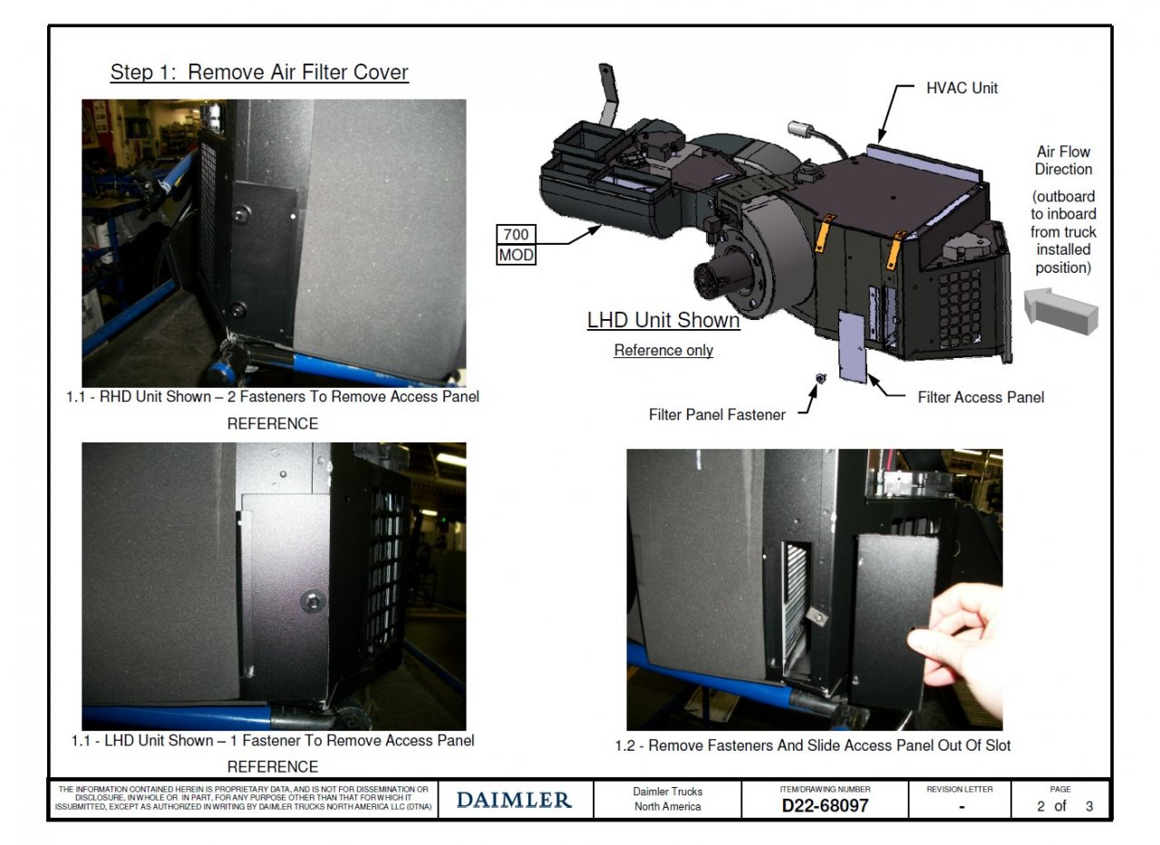

    Never personally changed one in a 4900. But here is diagram I found for a 2014 4900. It looks like there is only one fastener.
    Bledfor Days and QUALITYTRUCK Thank this.
  8. Bledfor Days
    Bledfor Days Bobtail Member
    14
    19
    Jan 9, 2016
    That helps a lot. Thanks.
