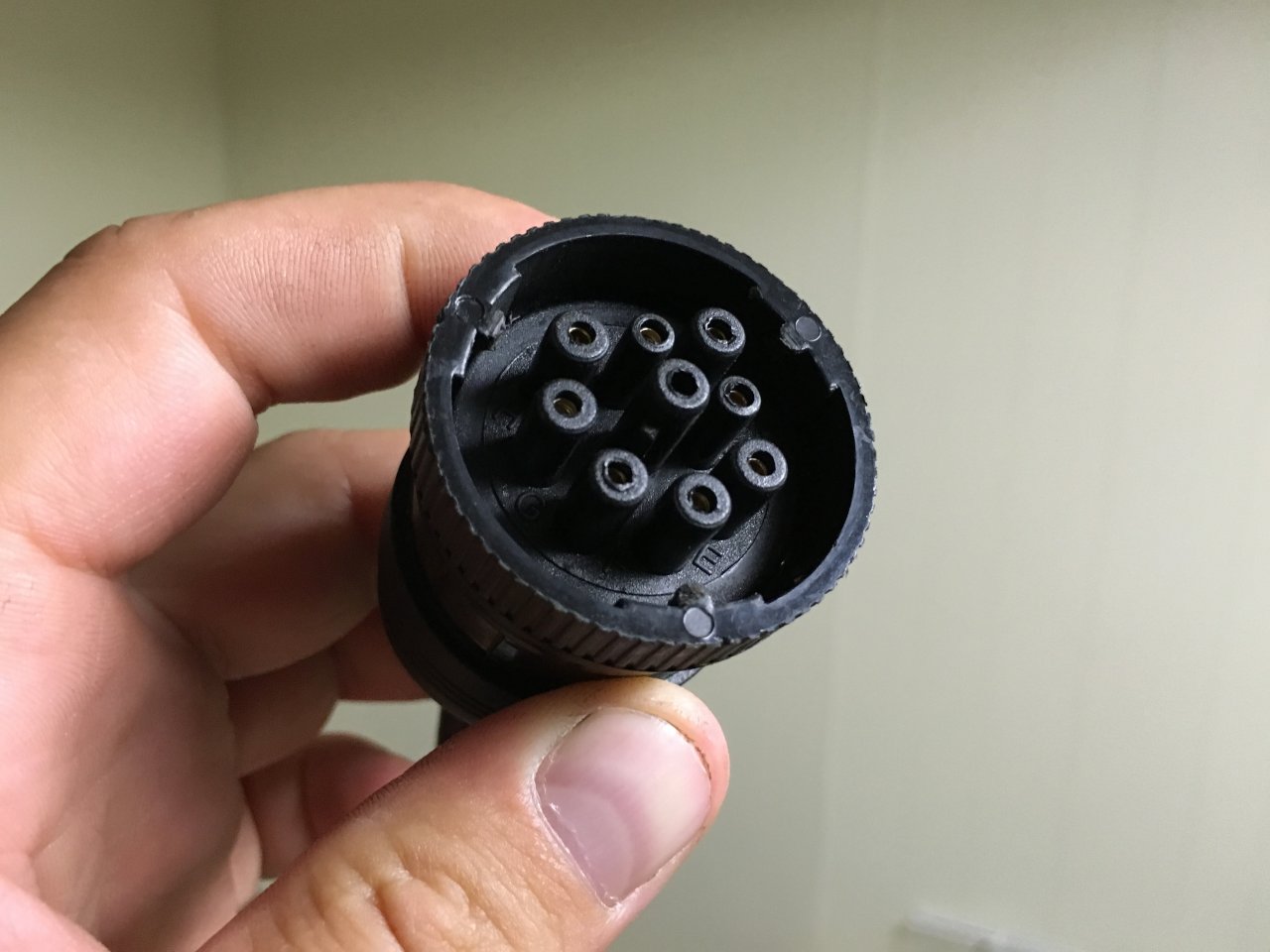

    Should I get a J1708 cable and give it a try?

    9 pin cabel got both 1939 and 1708 lines.
    Volvo8873 Thanks this.

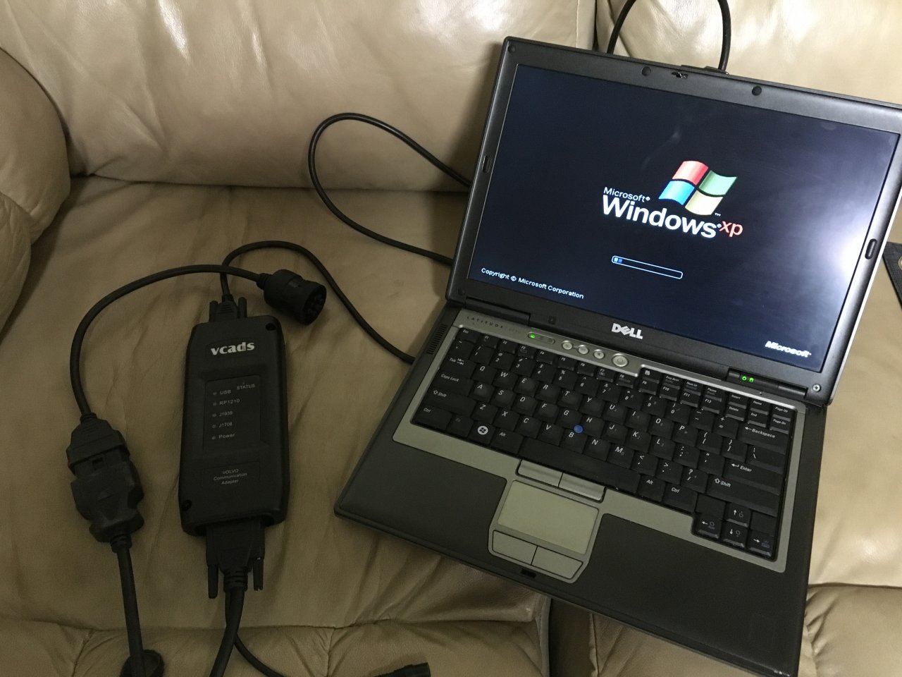

    Understood thanks. Here's my set up. At 250$ it was a gamble really if it did work. Going to play around with it some more tonight. Could be the cheaper J 1939 cable I bought but I am going to sift through some files and see if I didn't install something right or wrong.

    chenese adapter is made cheaper than genue one
    they use USB power supply and RS232 cabel
    and no optronic link from J1708 chip to MAX232
    That's why it is so cheap
