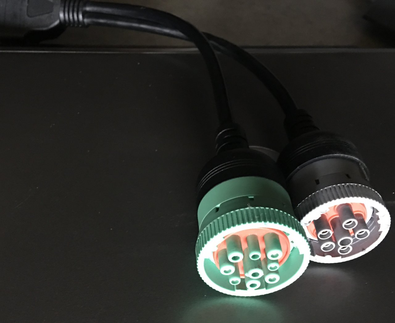

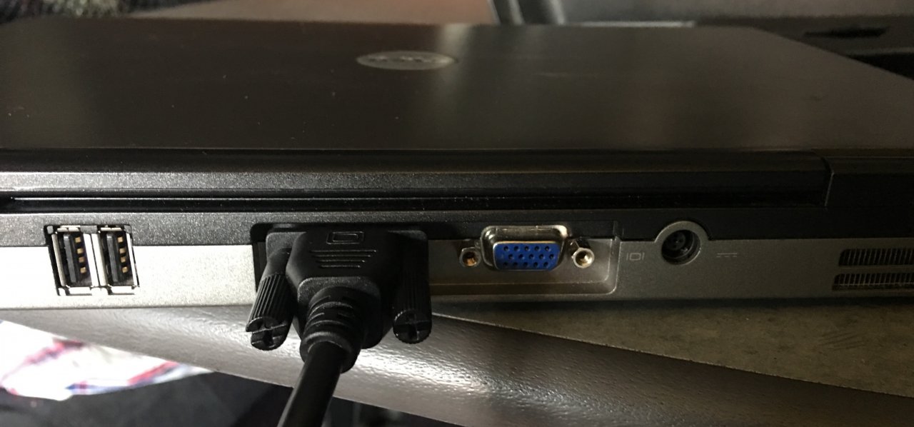

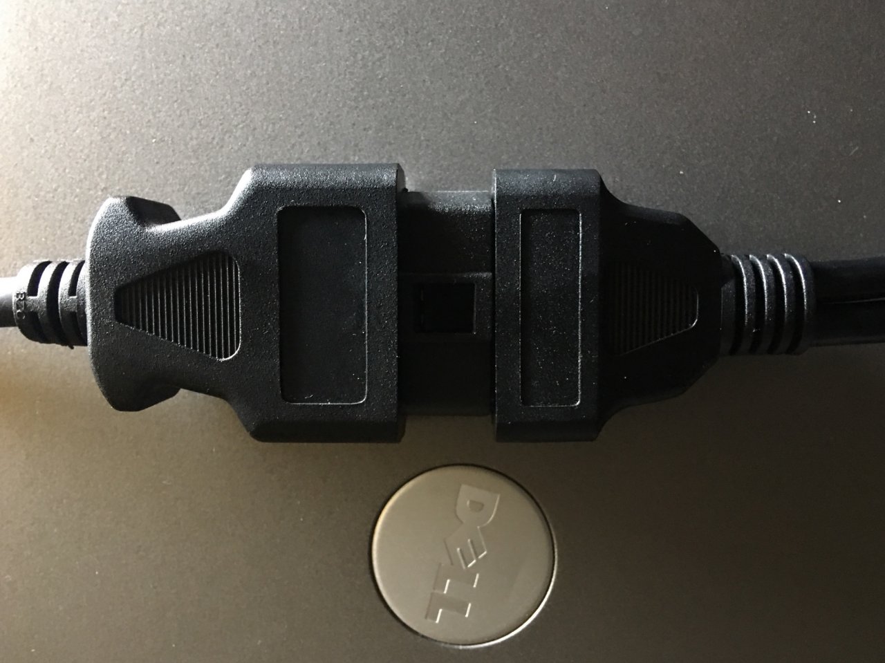

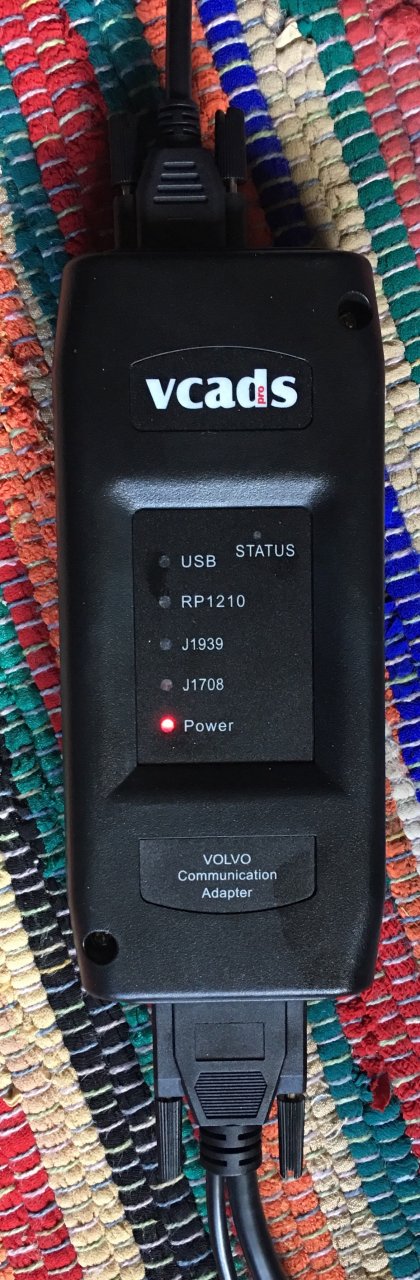

    Hello Pabo,
    I purchased a set of Chinese made VCADS for my 2007-D16 and 2010-D13. It didn’t come with the 9 pin so I bought a cheap 9 pin-6 pin to OBD adaptor. I followed the instructions and installed it on my D630 laptop. The problem is when I hook it up it only scans to 10% and disappears and I get the message 56001 also no communication with vehicle. Please can you help me with any ideas on how to get it to work. The Chinese support service is not helpful. Below are pictures of my setup. Thanks a lot man!
    C81ACDFD-0712-471E-841B-CCA7A364DF5C.jpeg 7BE8D204-F7C3-4638-AF33-E6E15355C172.jpeg CD47666A-0E21-4D23-91F5-89D7EB3E1A20.jpeg 3BEC68C7-2BEB-4BA4-ABCE-33BCB51D2065.jpeg
