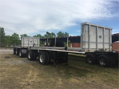

    This thread is 3 years old. Sorry have to add to it. In the 80's and 90's there were two sets of City A trains in Ohio. Dollie doubles. Owned by my father. Spring Air lead and Air spring pup. With the air bags ahead of fifthwheel. 31k light weights. Man did they pile the iron on.

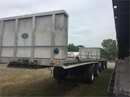

    As weird as it maybe, this week I found these on truckpaper. I know they were my dads because I painted the city emblems blue with gold letters to match his tractor. The lead has the ramped out fifthwheel plate that John Keller built in Tiffin Oh. Tractor had a box with firestone bags in it to push up on the trailer. I am not sure if the dollie is original. I dont think it is, but I see a fifthwheel lock in there. It was a brake chamber that shoved a pin up threw the fifthwheel plate in to trailer to help backing up. Lots of people were amazed when they watched him back up dollie doubles. Someone added container locks.
