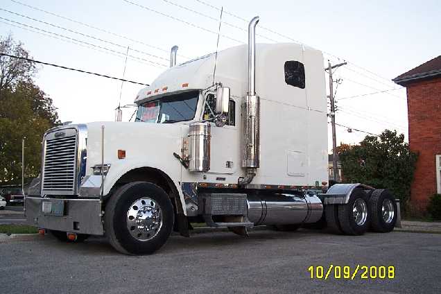

Suppose it would help if I put the crappy picture up eh?

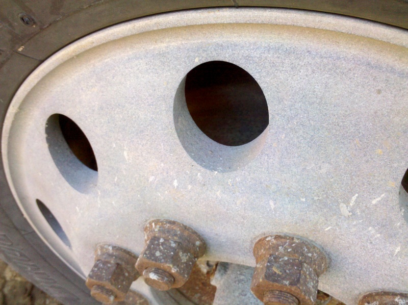

Here's a close up of the steer and my pusher rims, im guessing that they are etched because they are pretty rough.

The only way your going to fix those is to have them machine finished. You can sand them by hand and polish but no way your actually going to do that. WAY too much work.
