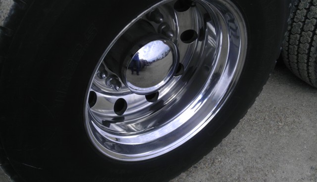

    @STexan Durabrights look good for maybe a year, then the coating gets pitted giving the appearance of a dull wheel. My trailer used to have them. I paid to have the coating sanded off and the wheels polished in Fresno.
    I like shiny wheels........

    @Long FLD it took me a second to notice the driver in that picture, nice truck btw.

    What condition were the wheels in before you took them in, and how many wheels were polished for eighty bucks? If that's the cost for a six-pack, that ain't bad.
    Just the wheels without the tires mounted, .... right?
    They look great.
