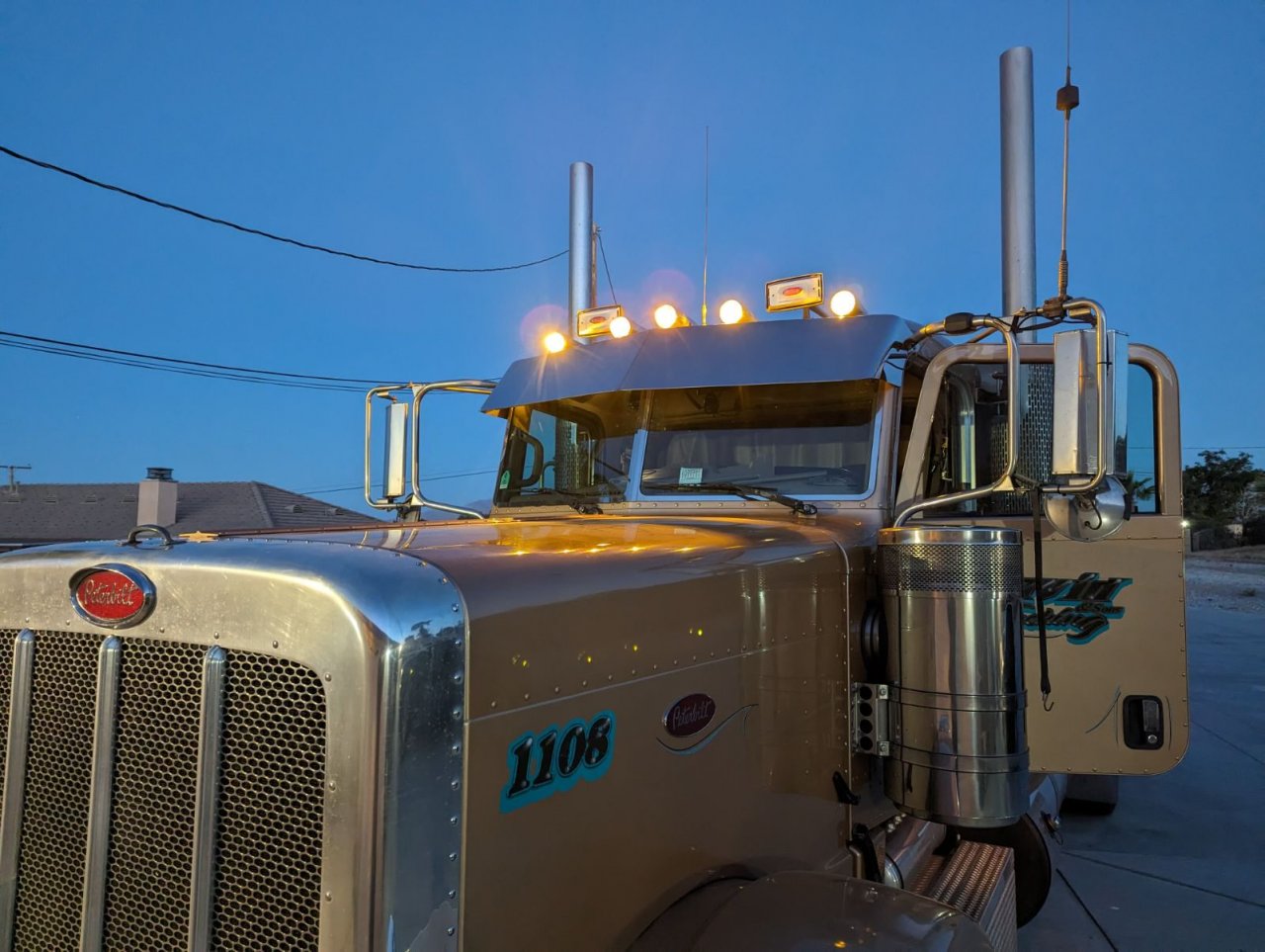

    I just went from LED cab lights to incandescent, because the LED’s were flickering and 1 or 2 would get dim. I couldn’t fine replacement insert’s, seems the whole cab light was one whole piece. So I changed the guts out and made them for a 1156 bulb with watermelon Glass lenses. My question now, I want to go with the LED bulb replacement type, which LED bulb is the way to go, referring to the 1156 type or do I need a smaller type. I’m trying to draw less current is my target but keep them bright.
