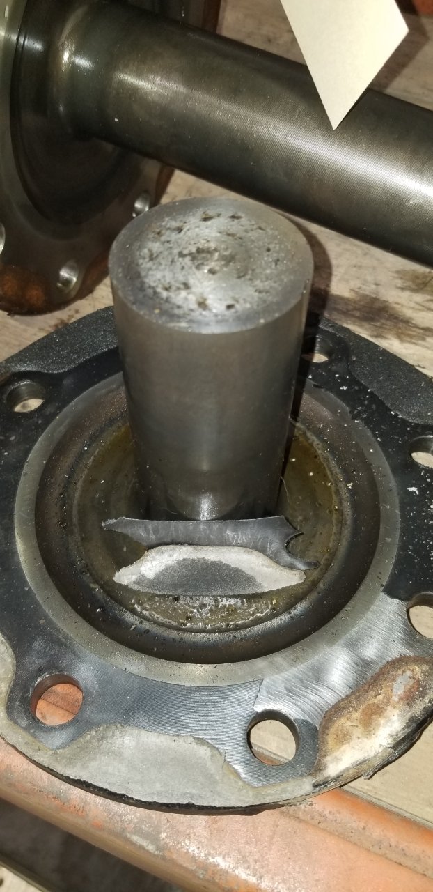

    25 years ago I broke 2 smooth and clean like that in the 8.2 10 bolt BOP rear in my ‘65 GTO. Both were oe original axles and both on rightside. The second one was a left axle from another rear that I put in the right side to replace the first broke one. It actually twisted at the splines but snapped about 2 inches away from splines. 4 speed stick, slicks, and a sticky dragstrip had a lot to do with it tho! Lol!
    I have never personally seen a big truck axle break like that. Overheat and Grind down at the bearings or twist a little yes but snap in half. No.

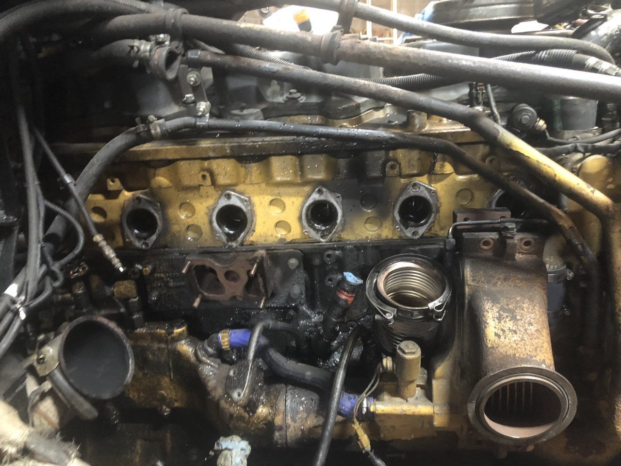

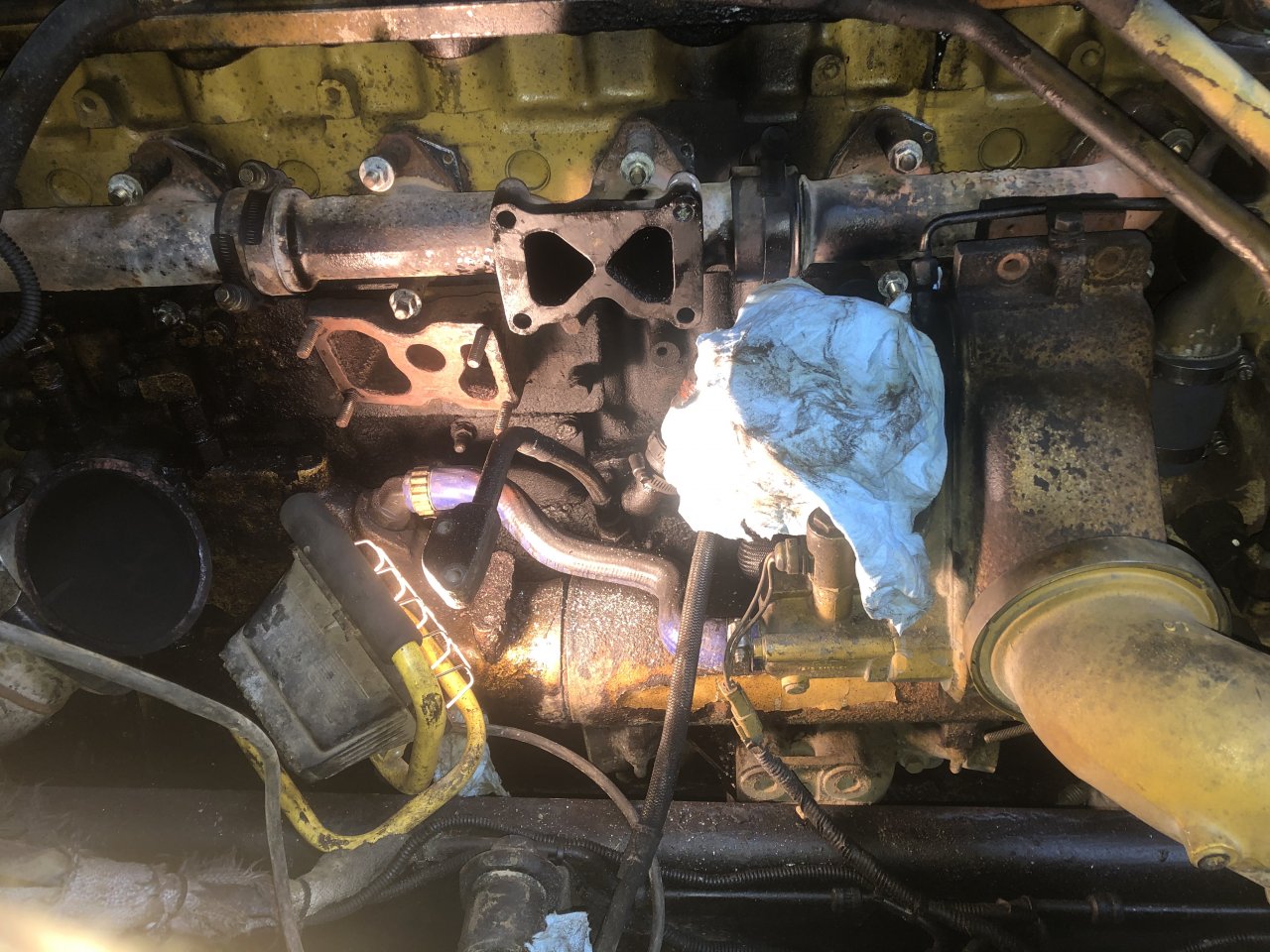

    While floating a excavator the truck drove nice on the way to the job site 45 mins away.
    On the way back to the company, the truck was powerless while empty.
    I open the hood to see what was wrong.
    All four studs holding the small turbo to the manifold snapped off.
    I removed both turbos.
    Tried and failed to remove the broken stainless studs. Kept getting dull drill bits.
    8F42F57D-F49F-4083-9B98-D31C93DF2875.jpeg 6C1F21C0-58E8-47F9-BAE4-1CC07C986A76.jpeg

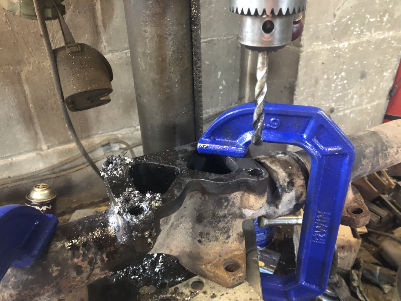

    Took the manifold off

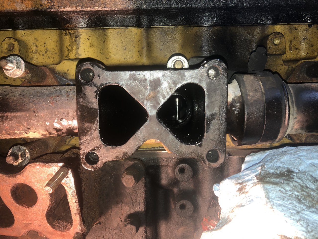

    Drilled all four stainless studs out in the drill press.

    The four studs were 1/4 inch below flush.
    The one stud I managed to drill far enough after several drill bits, I tried using easy out, torch, and water. They won’t budge.
    So the manifold came off and into the drill press where I used a concrete drill bit.

    Try using an end mill, it leaves a nice flat surface to work with.

    I do have end mill experience. We don’t have those bits here.
    I decided to drill through and use stainless bolts from this point on, just like a lot of other trucks use.
    Then if that snaps, just install a new one instead of removing turbos and buying more gaskets and fighting with broken studs. :cool:
