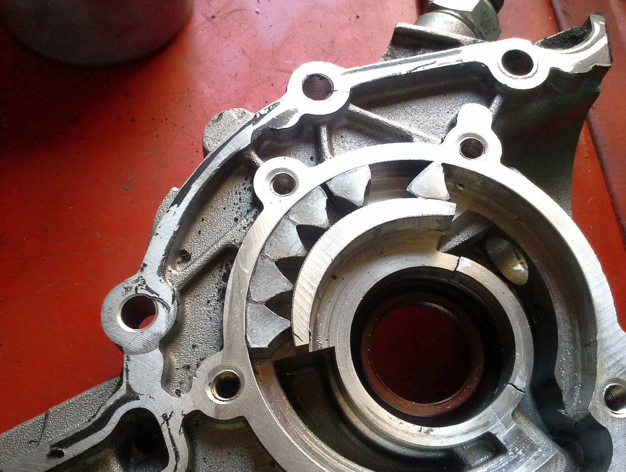

    Not a truck but this one still has me puzzled as to why this happened.
    Oil pump of GM 1.6 4 cilinder. Very low miles on engine rebuild, with new oil pump.
    Car got hit by another car, engine was still running, and driven home after the hit.
    At home the oil pressure light came when engine was idling.
    After turning off the engine it would not crank any more.
    Turning the engine was possible but only for like 30 degrees crank rotation and then it was blocked.
    Clutch depressed or not, no difference.
    Maybe hydro-locked, but coolant level and everything was OK.
    Removed the spark plugs,still the same.
    Checked inside the cilinders, no piston to valve or head contact.
    Removed oil pan, crank or rods did not hit anything, nothing strange there.
    Removed timing belt, camshaft rotated normally.
    Removed transmission, same thing.
    Removed pulleys from front of crankshaft, same.
    Removed oil pump from front of crankshaft, and crankshaft could be rotated again.
    Opened the oil pump, and every single tooth was broken like this....
    Cleaned oil passages in the block, put on new filter and pump, checked mains and rod bearing (no damage at all) and engine ran fine again.
