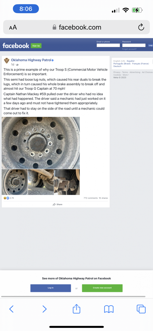

    So what this tell us is........
    He hasn't done a pretrip in the last few days???
    I dont think I would have told the trooper that. I hope he didnt call the safety dept & complain to him about it.

    Yeah, i saw that. Just doesn't add up. Sounds like OK DOT is like my local Freightliner dealer. Just baffle with BS

    A spindle, with no brakes, drum, s cam, or slack adjuster? Just magically all fell out? I would say this was taken apart, and left apart. Got inspected and ole DOT thought it would make a good post with many likes if thet said it hit them.
    What exactly almost hit them? I'd love to see dash cam footage. Otherwise, i call BS

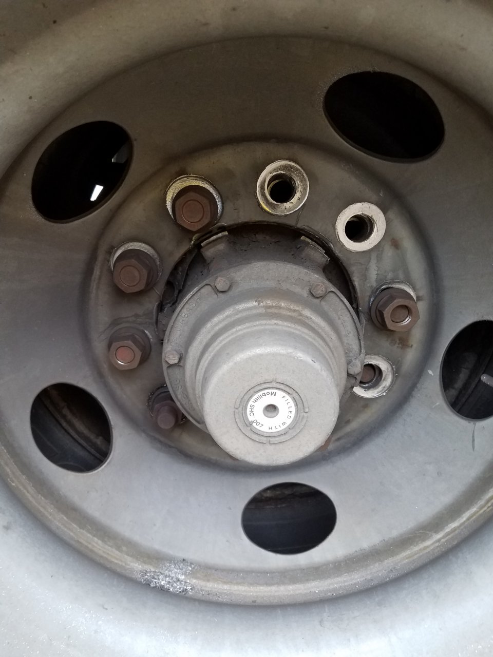

    Tell that to the trooper who almost got hit. The lugs that came off probably hit the trooper’s vehicle. Lug nuts are like rocks,they can crack a windshield or do other damage!

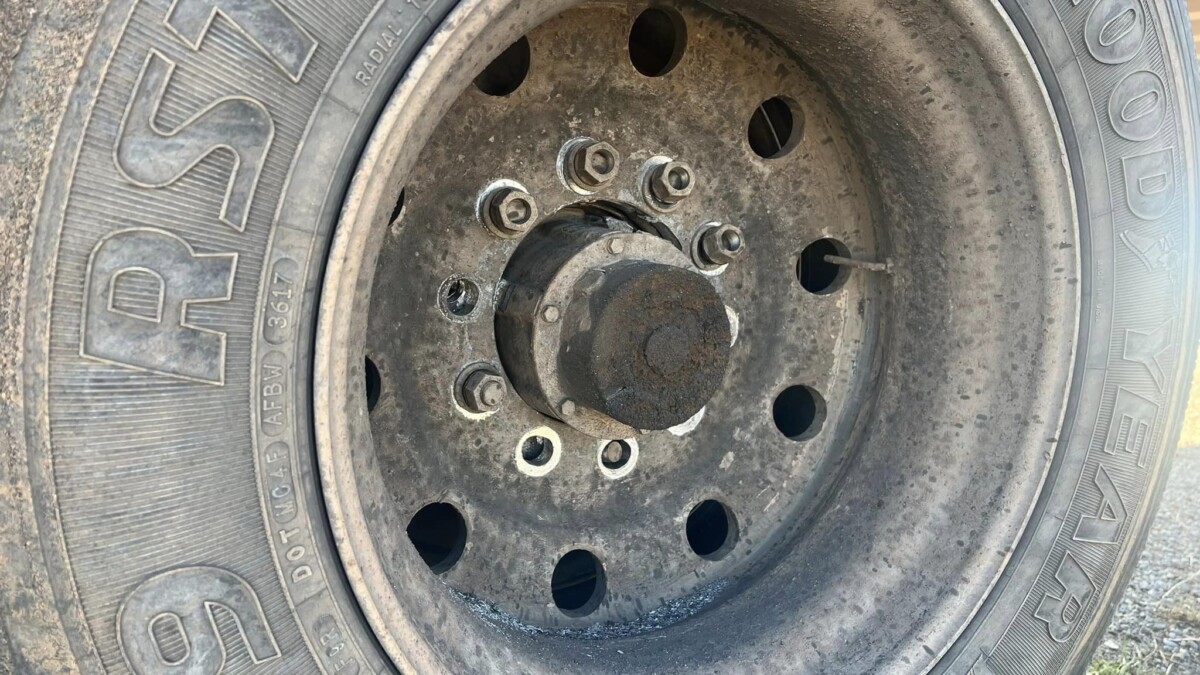

    This one I'd had for three days. Trainee started his enroute while I was finishing something else. I did my enroute as he was updating the workflow. I got back in the cab and said "did you notice anything wrong?", then we took another walk.
    This one was a drop trailer that someone had called in for a tire. We picked it up as our first trailer and I pointed out the sticker on the tire and how it had just been changed - trainee even tried hand twisting the lug nuts. We made it 20 miles down the road.
    Based on the fact there is a bungie cord doing something, I assume driver incompetence, but sometimes stuff happenes.

    The lugs? You mean the broken wheel studs? The nuts? If a trooper tried to tell me what they are saying happened, i'd question it.
    Their post says"the whole brake assembly" almost hit their vehicle. Absolutely no way possible the drum, shoes, s cam and slack adjuster came off as an assembly.
    BS. If were in the Book of Faces, I'd call BS right there too

    Yep. What are the odds that both clevis pins and the snap ring holding the slack adjuster to the cam fell out. Plus where'd the cam go? It can't walk out of the drum. If it walked in, it'd hit the hub before it could actually fall out on the ground.
    There's definitely far more BS in the story than truth.

    I’m referring to the lug nuts. Look at the photos-at least 4 of the lug nuts remaining are ready to come right off(more than likely they weren’t torqued to spec). Some of the ones remaining look misaligned with the studs. Possibly stripped or cross threaded.
    Somebody probably did a hatchet job with the “repairs”!
