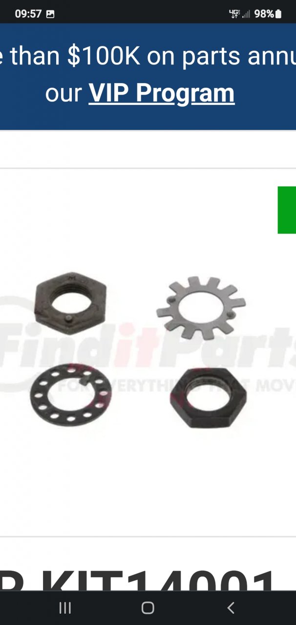

    Bearing preload, then back off etc etc, yeah, i know, im delightfully lucky, had an axle surgeon do one of my axles, so i needed the 4 3/8" 8 point AND the 4" 6 point, lucky me...

    When I did my wheel seals, three of them were regular 4" Axilock, and the last one was the 4 3/8" you have pictured above. You think maybe that's an Axle Surgeon situation too, or maybe just bad luck? I had to make my own socket because I didn't want to drive all the way back to town.

    On the spindle, axle surgeons info is printed on the center top, it should have been obvious when you cleaned spindle
    i should have checked but didnt, thread may be interchangeable and therefore if the tab washer or something was messed up they just grabbed what was available, gotta say i like the 2 peice big 4 3/8 with the internal locking washer, no question of "did i bend the tabs out or not?" Its in there, or it isnt

    Okay, my spindles all looked the same. I don't know what an Axle Surgeon repair actually looks like.

    More recent is what they look like :p
    Did look it up though, supposedly the stemco pro-torque fits the old 2 nut 2 washer style. Personally i may buy 3 more of those just so everythings the same and i only need 1 socket.
    Other advantage of the protorque is deeper thread engagement
    and the socket while it doesnt stay on the nut, it bites better since its deeper

    My other three spindles run this:

    ah, interesting, cats skinned and all that...
    This style is what i have in the other ones
