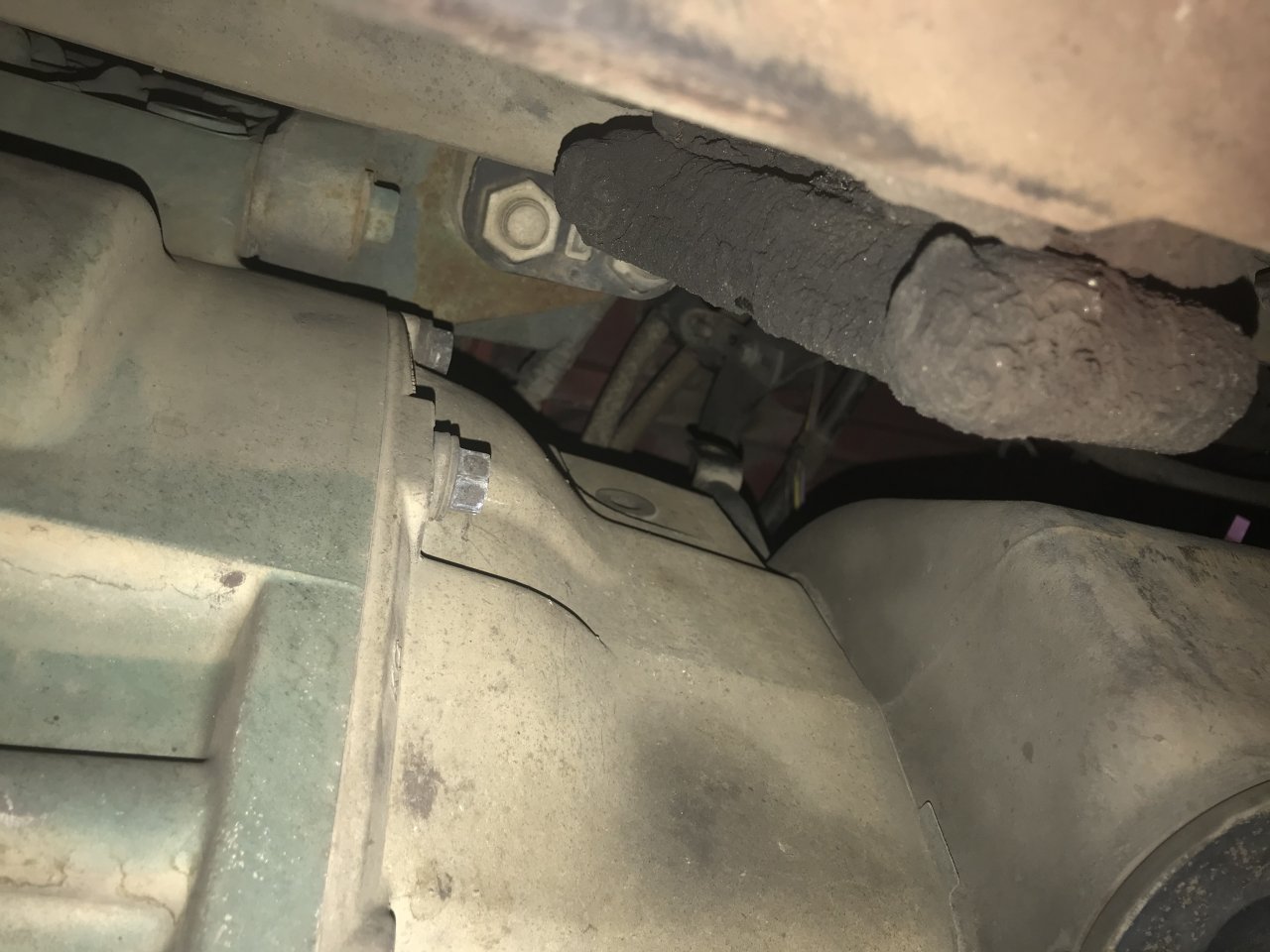

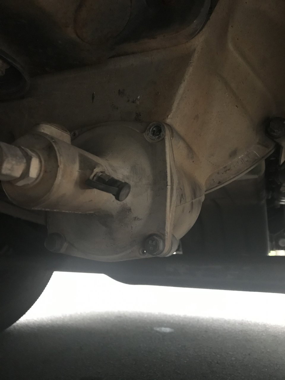

    I've got a strange question- I have an Eaton 10spd and when I bought the truck it was missing the inspection cover under the throw out bearing since it's been making some dry bearing sounding noise I've noticed it doesn't have a grease fitting anywhere. Do some models not have a greasable bearing?

    Sometimes they don't put the whip hose on when they replace the clutch. Look right up inside the housing, on the bottom of the bearing. Should be a grease fitting threaded right into the release bearing.

    Also check on each side of the bellhousing. Should be grease fittings for the release fork cross shafts as well.

    Thanks! I'll post a couple pictures on what I'm looking at here shortly. Still not seeing something

    Here are a couple pics of what I'm seeing. Still think it's the throw out bearing dry I don't notice any grease in there at all. When I push the clutch in the rattling stops thanks for any help 615F367A-7AB8-4BEF-A7D0-4872A93364E4.jpeg 1D577FDB-EF49-46F8-81EC-642A58CFA0F4.jpeg

    Here's one of the I'd plate and where the clutch cable comes in 5494261D-6ECB-45FC-A9B4-FF6C91A68C1D.jpeg 13873A79-3B7A-4068-AC32-40A339188973.jpeg
