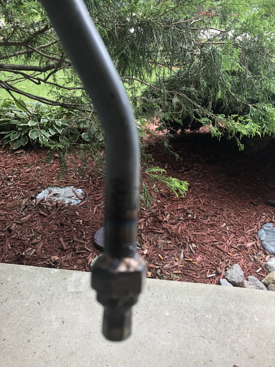

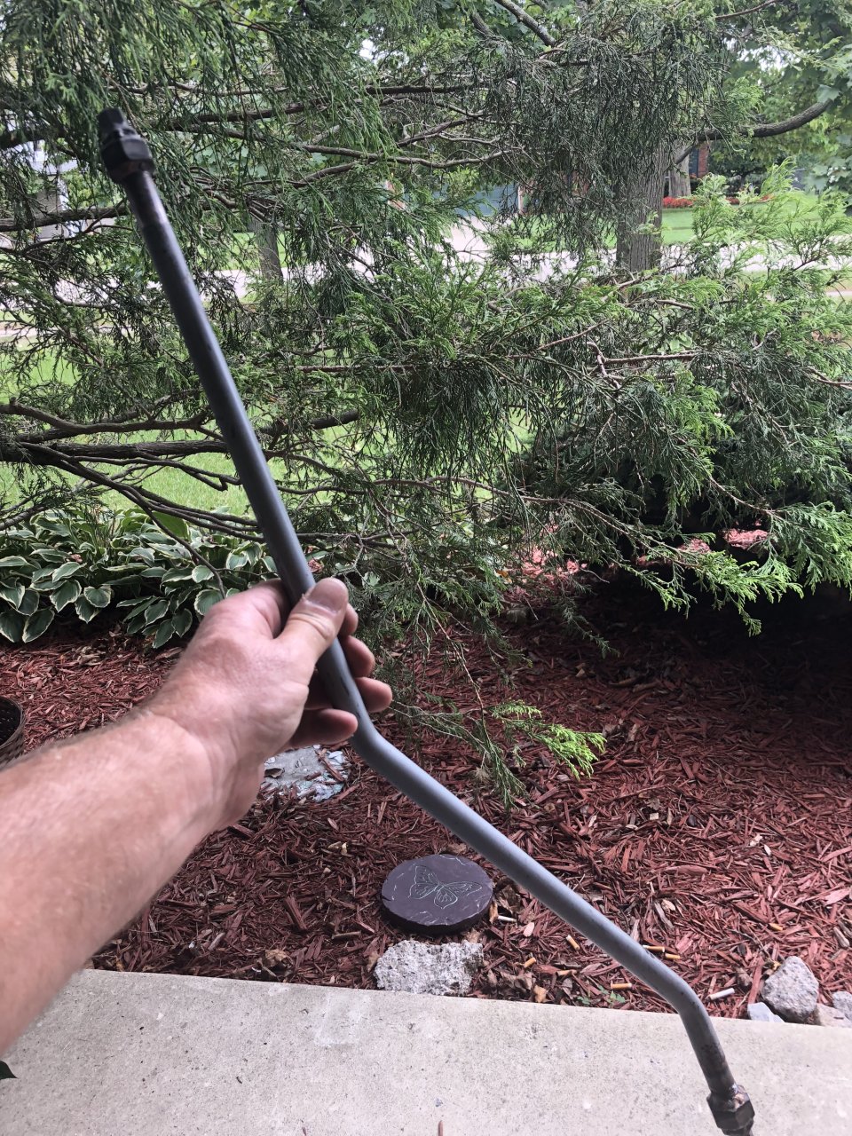

    2B4D8144-D795-4C7F-826C-ED7DE67852C9.jpeg D14CF721-C2B2-4FD1-8C56-F94399886E51.jpeg 67452E37-77B1-4897-95D0-0E439058D8DB.jpeg Here’s some pics outta get a good laugh out of someone. Was under a load on a Saturday night. Decided better put new part on and snapped old one off in the rod had to improvise. It worked ran a week like that had welded better than new $25 vs $200 It ain’t pretty but it’s strong

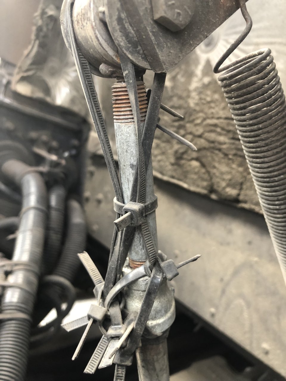

    that's some real "Mc Giver"-ing you got there; Gotta give you credit,
    but if your on the road, and only other option is call for an $800 Tow, Its Beautiful.
    ALWAYS have wire-ties, duct tape, and a small roll of steel wire in your truck toolbox.
    I blew a hole in the big air hose right off the air pump, it was stainless braid covered hose,
    took 4 rubber gloves and 40 wire ties and got it home.
    Threw it out - I shoulda took pictures.
    It was ugly, but beautiful - like this.
