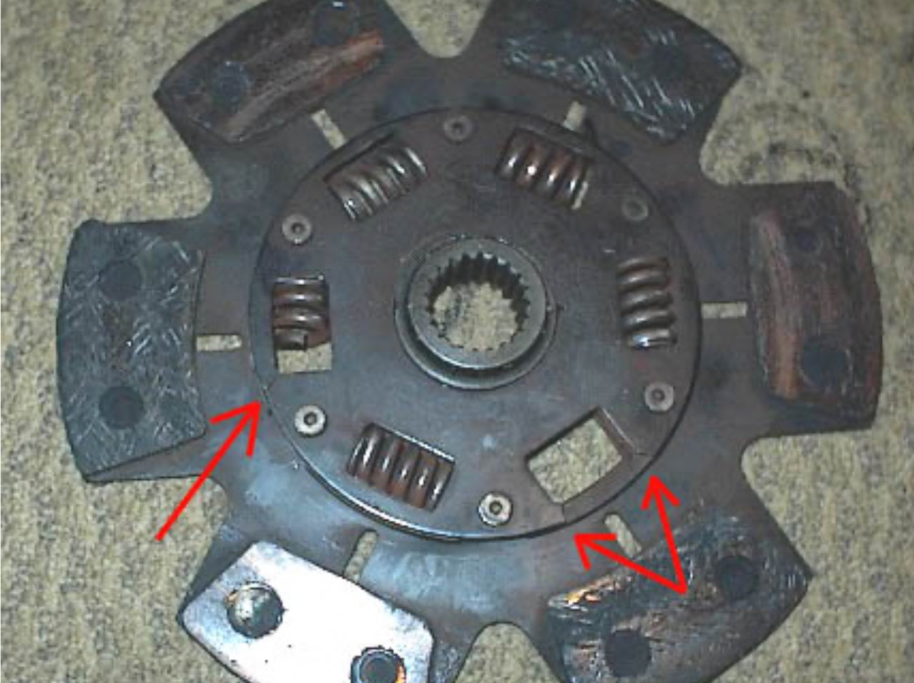

  9. Hulld
    Hulld Road Train Member
    2,884
    6,567
    Oct 19, 2015
    Upstate NY
    Here’s a picture of one with broken and missing damper springs
  10. bad-luck
    bad-luck Road Train Member
    3,315
    6,092
    Nov 16, 2013
    Baltimore, Maryland
    I had 2 spings break, pedal was fine, but vibrated like crazy. Excellent pictures and description
