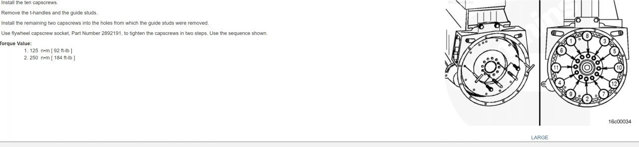

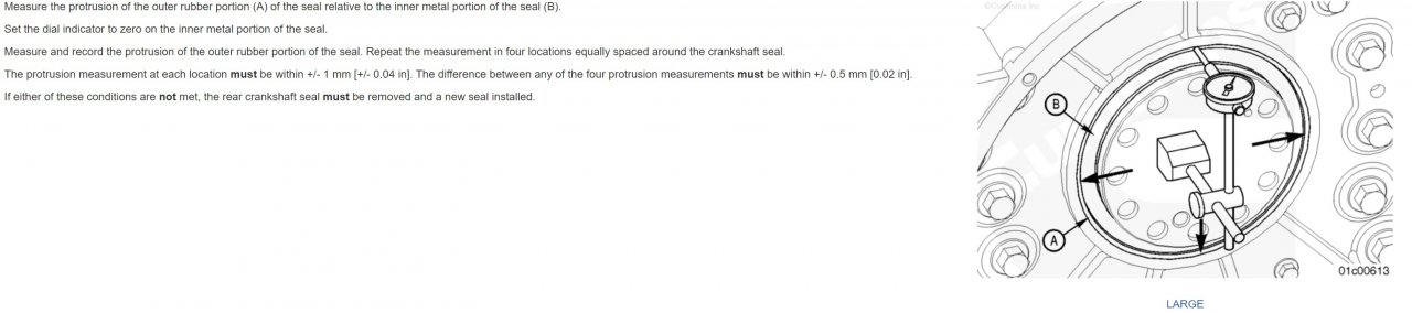

    Crank seal install and flywheel torque. Not saying you did anything wrong, just sharing the manual.

    The plastic spacer is designed so it fits into the OEM seal driver tool. As long as the seal is flat across the front and not separated it should be ok. You can run it like @BoxCarKidd said to verify its ok before putting in the trans. Post up a pic of the seal and seal to crank.

    I'll post a clear pic tomorrow. Right now, the steel part of the seal is inset maybe 1/16th inch deeper than the rubber, maybe a little less. But they aren't flush with each other.

    I'm not taking pics. I looked at the old rubber, and it's thick and strong. No way I damaged it installing it the way I did.
    However, the manual explicitly says in bold lettering, do Not use lubricants during installation. And That the soap and water helps the seal bond to the case. I'm afraid the only "bonding" gonna be going on under my truck is a puddle of oil bonding to the ground after it leaks out of my bellhousing. So I went to town and bought a new seal. Lessons learned...

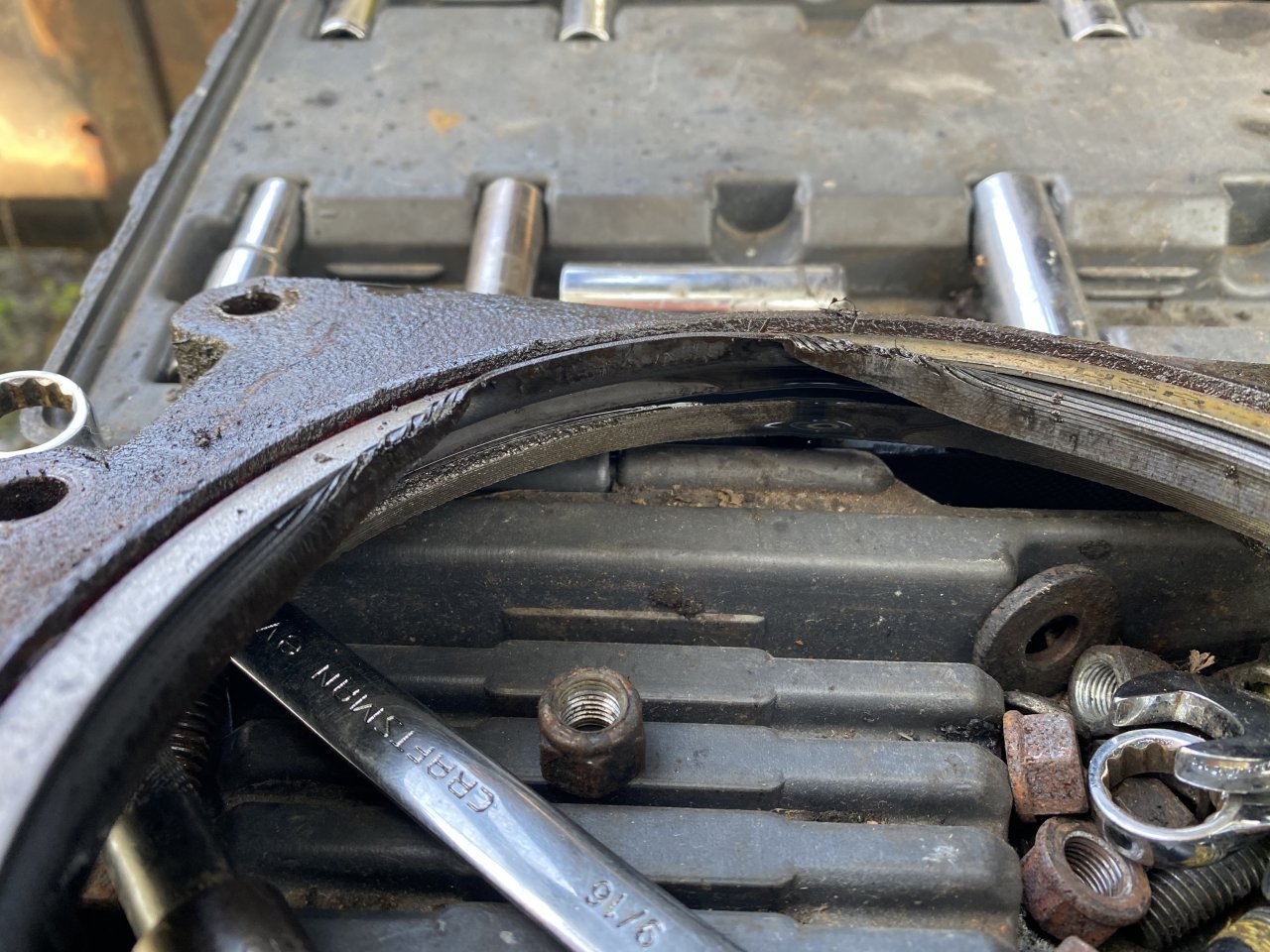

    This seal was pushed out and damaged from to much crankcase pressure.
    They are not as robust as you think.
