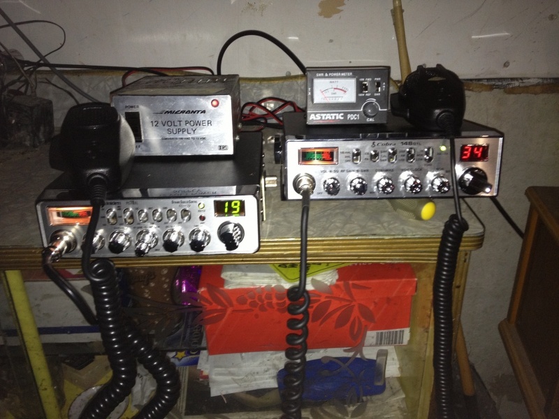

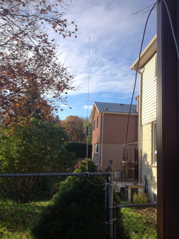

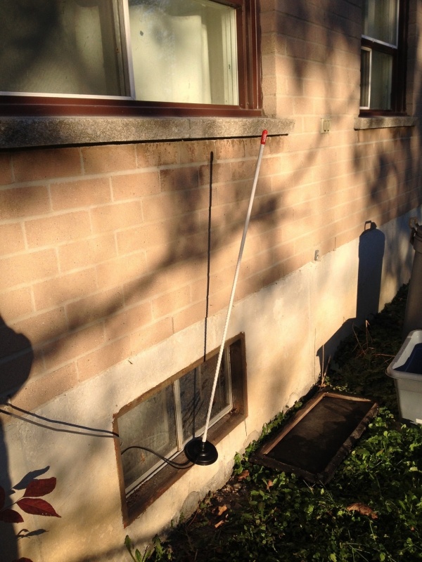

    Squealing problem is fixed now. I plugged in the stock mic that came with the radio and there was no squeal when I keyed up. Then I plugged the power mic back in and it would squeal like crazy again. Unhooked the mic extension cord and plugged the power mic straight in and it stopped, so something is wrong with the extension cord. I've also got 2 new antennas rigged up and they seem to work better. Something must be wrong with the Wilson coax because I couldn't receive or transmit anything with it since I bought the new radio.
    Here are updated pictures of my rig, I've moved it indoors now because of the approaching "4 letter word season".
