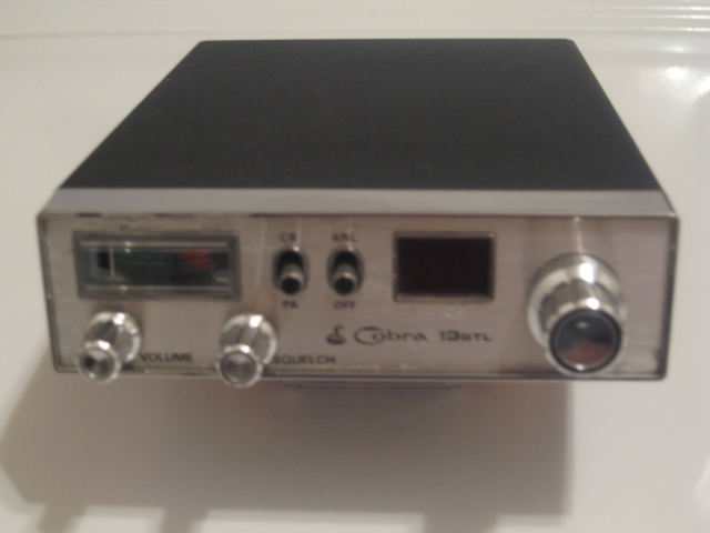

For what it's worth, below is my old set up which consisted of a Cobra 19 and a 102 whip. The radio was a standard 3 watt dead key/10 watt swing radio. With a low 1.5:1 SWR, I could get out 3 + miles easy!Attached Files:

yeah 9 foot whip will kick it REAL GOOD
