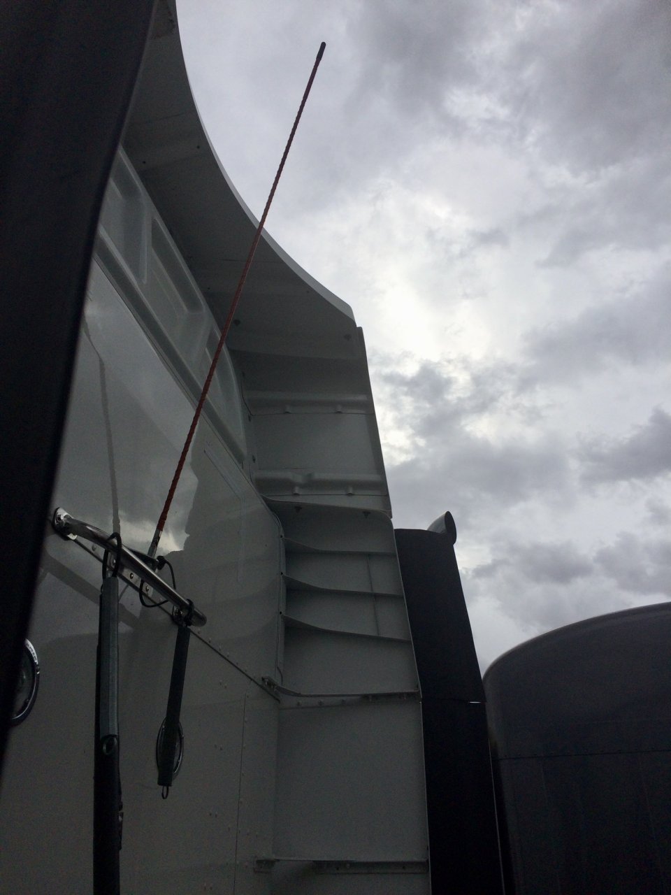

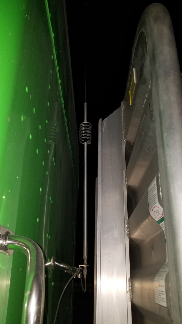

    That picture in post 18 makes me cringe. The antenna is not only low, but the adjacent metal looks like it would be detrimental to any RF in the area.
    That picture makes it appears that the antenna is challenged by not only height, but also metal close to the coil etc. Neither is good for RF communications.

    Mounted on that headache rack would be better.
    Antenna height no more than 13’5”
    A different antenna may be called for.

    So do you suggest moving the antenna to the rack and shortening its overall height to stay at 13'5?
    I appreciate all you guys help I'm cb illiterate but can pick up things quickly if someone teaches me what I need to do.

    No, don’t waste money on a peak and tune job, it won’t make any difference with your inverter noise problem. Don’t blame the antenna, it’s just doing its job. You can verify that by unplugging your coax from the back of the radio while the inverter is on. If the noise goes away, it’s not an electrical problem through the binding post.
    The big problem I see is the location of the antenna. The metal from the vehicle needs to be under the antenna, (as much as possible) not beside or around the antenna. Unfortunately with today’s plastic trucks and mirror mounts, that’s not always possible. You may not have a choice but buy a shorter antenna such as a Hustler FG27s (that’s what I use on the pete I drive, and mount it on the mirror, if it’s the old conventional style mirror mount. Plus run a separate coax. I’m not saying this will get rid of the electrical noise, but it should be a big improvement getting out farther, rather than trying a peak and tune.

    And I'll likely move the antenna anyway since it's between two pieces of aluminum (I'm guessing the back of the sleeper is aluminum) And it's got the plastic mirrors so a mirror mount wont work and it doesn't have the studs to put one of those style mounts in either.
    Next biggest issue is being able to get the darn thing off because I cant reach it.
