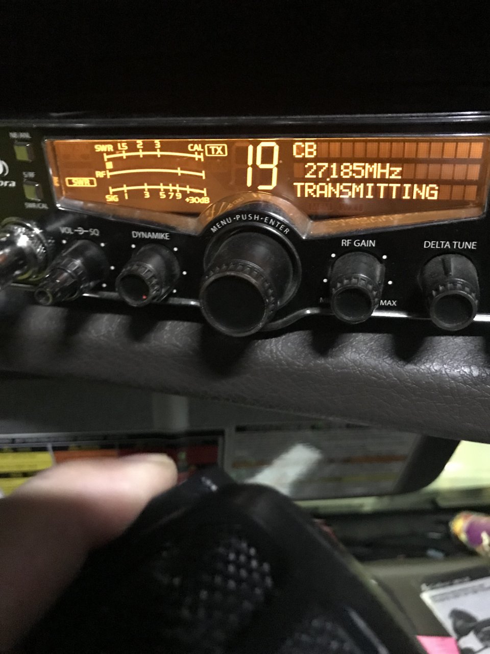

  5. Midnightrider909
    Midnightrider909 Road Train Member
    2,385
    9,589
    Oct 26, 2016
    This is what the display looks like when I transmit. 5F6D296E-1AD9-41F5-92EA-015E05D9853B.jpeg

    I assume it's been working and then quit? Not sure what you mean by calibrated, unless your referring to using the worthless internal SWR meter. Do you have an external SWR meter to see if it has RF output? These cobras are known to have lots of cold solder joint problems. That's what I expect is going on. More info would help.

    Okay after a closer look, I see your in the SWR mode, and like usual for these radios, it shows around 1.2. You still need an external swr or power meter to verify if it has RF output. Unless by no transmit you mean no audio.

    Okay, have you tried the PA to see if you get audio through the internal speaker? Be sure and turn the mic gain way down before you key the Mic. Then as you talk, slowly bring the mic gain up and hopefully you will hear yourself talk. If this works , then the mic and audio section is good. It's still possible there's a cold solder joint somewhere or the TX final is bad. Tnx for the picture, that sure helps to see what it's doing.
    I'm not sure the TX final is bad just yet. It sounds like from your first post that you were able to calibrate the internal swr meter, which sounds like you are getting RF power out. But how much we don't know without a power meter.
