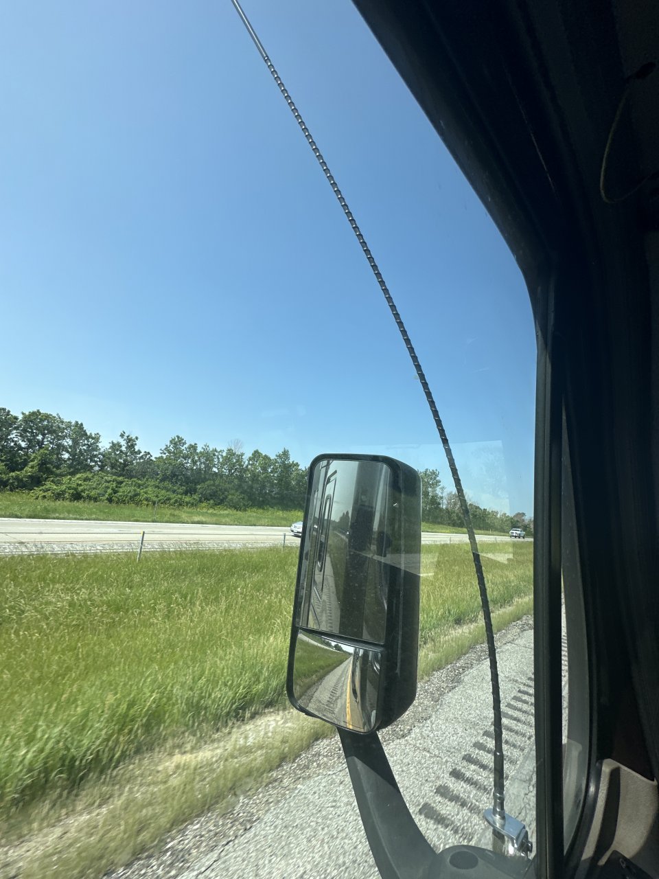

    Ok so bonding straps aside. What can I do about my antenna sway? That does also affect reception correct?

    Do what others are doing. Buy a 2 or 3 foot of 1/2 inch PVC pipe at a hardware store. I think it's 1/2 inch, you will need to measure the bottom of your antenna and buy accordingly. Paint it black to match your antenna. Since your antenna is 6 foot long instead of 7 foot, try a 2 foot piece of PVC first.
    On the bonding video from craigsez that I sent you, fast forward towards the end of the video. He does a sweep of his antenna and truck, and you will see the painted PVC pipe. It's hard to tell unless you're looking for it on the antenna.
    A long antenna swaying in the wind could effect the the signals, but I would be more concerned about the undue stress that is put on the mirror mount.

    Ok, and all I need to do is slide it down the antenna?
  8. Night Stalker10
    Night Stalker10 Road Train Member
    1,697
    1,271
    Jun 26, 2017
    Yes. Just make sure the pvc slips over the metal base at the bottom of the antenna.
