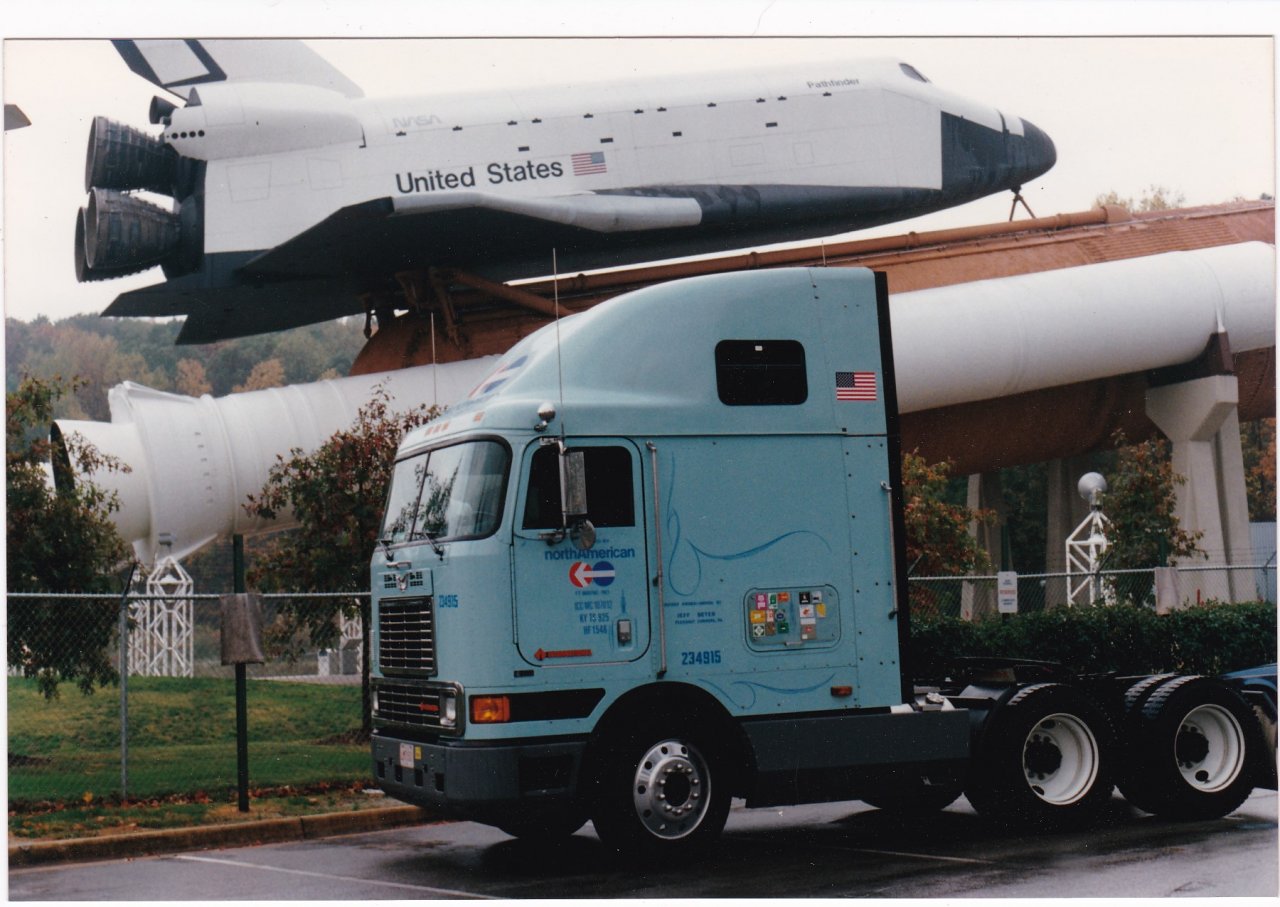

    Here is my 1990 IHC 9700 High Rise about a year after I bought it. Used this photo for a Christmas Card 1990 IH 9700.jpg

    I had a '94 like that with a set forward axle. Had same logo on the door too. Was the first truck I owned.
    Studebaker Hawk Thanks this.

    Same logo on the trailer.
    that is how we knew which end to hook up to
    I remember when i started in 1976 we were the Swift drivers of our time....
