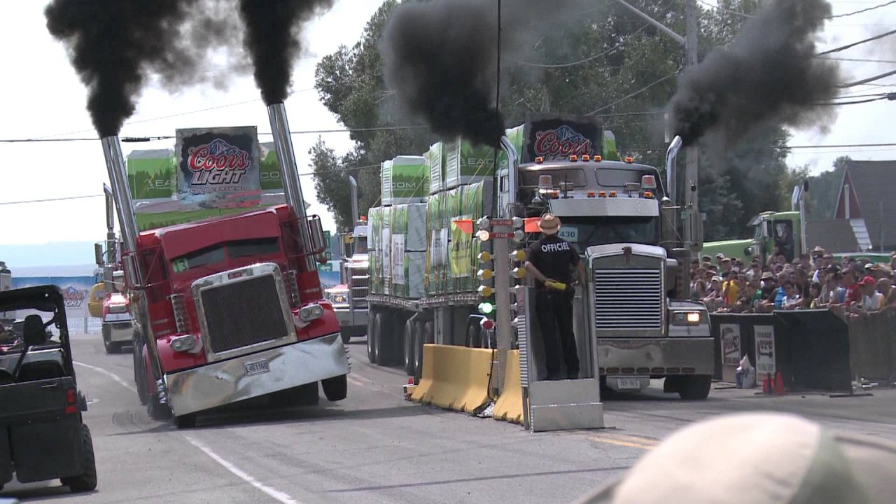

    Some of the racers in the french canadian circuit run compound turbos but as you can see they wony pass emissions maxresdefault.jpg
    Dye Guardian and Cottonmouth85 Thank this.

    That's pretty sweet. Where I live I don't have to worry bout emissions. Even on my ram truck with the compound setup and tuning my truck won't roal coal it's tuned very well.
